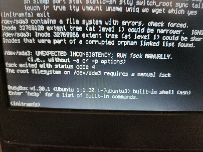

Hi, everyone! This is my first and hopefully only post that's this dire. I've been using my ASUS with Zorin on it for about 2 years, running Dolphin and RPCS2 and things like that. I'm in the middle of a MGS:TTS game, and my computer freezes. I restarted my computer to a terminal, not allowing me to progress past it, saying something about a /dev/sda3 needing a manual 'fcsk' run. I'm very new to Linux and just coding all together. If I could get some help sooner than later, it would be so helpful.

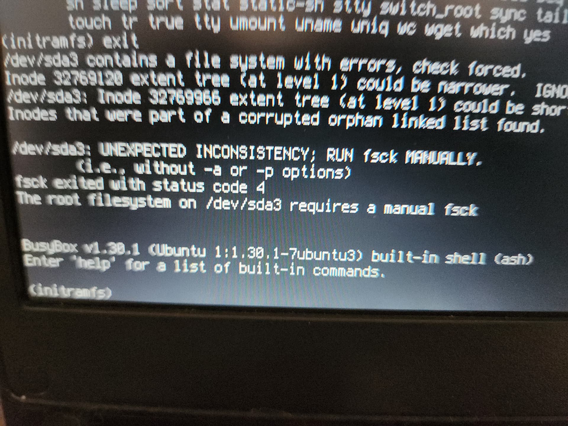

Thanks for the help, do you know anything else? it says (initramfs) and i can't type anything before it.

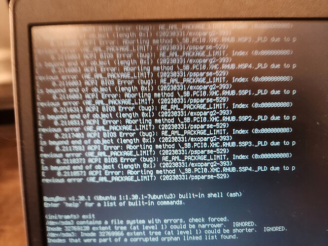

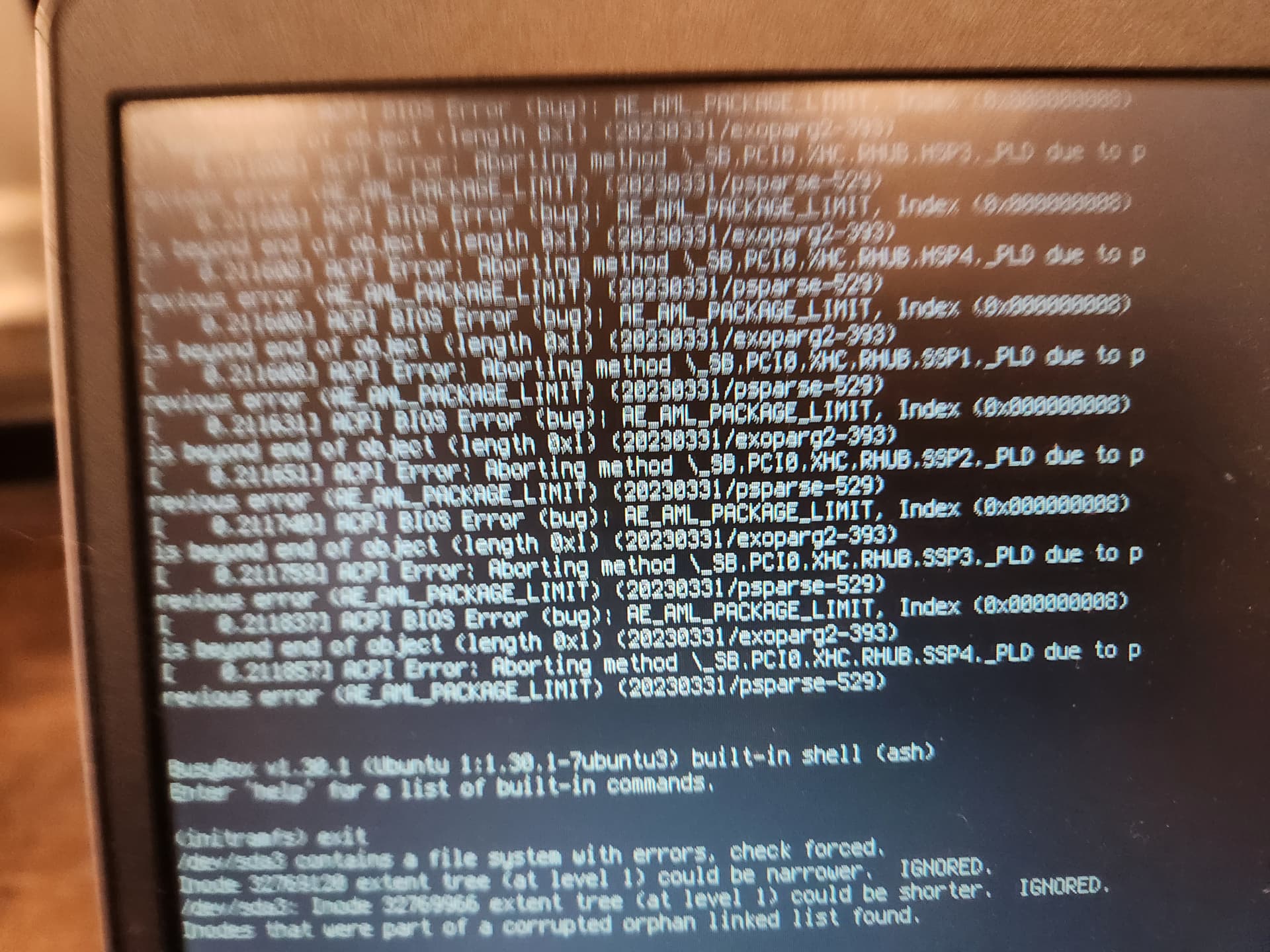

It also says this:
That is the BusyBox Shell, not access to the system - so you do not need to use sudo - just run the commands directly but without sudo.
