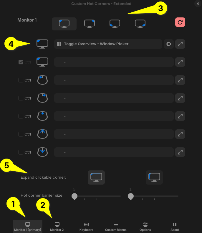

I think this extension can help you.
https://extensions.gnome.org/extension/4167/custom-hot-corners-extended/
Hi, thanks for your suggestion! Unfortunately, I couldn't figure out which option I need to activate to achieve this without any interaction like pressing a button or shortcut. Can you tell me where to find such an option?
Thanks!
1 and 2 = you can select the monitor
3 = you select the corners you want to use (you can set all corners, if you want)
4 = you select the function you want (it is not necessary to press a button or use shortcut)
5 = you can expand the corner area
