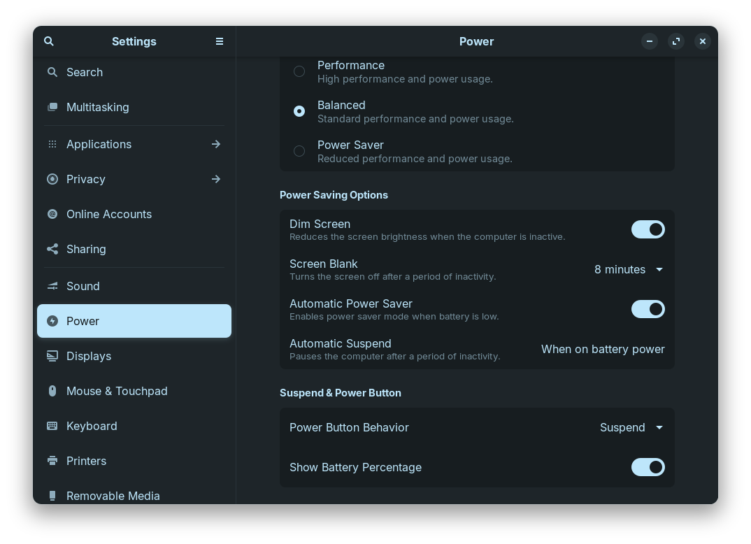

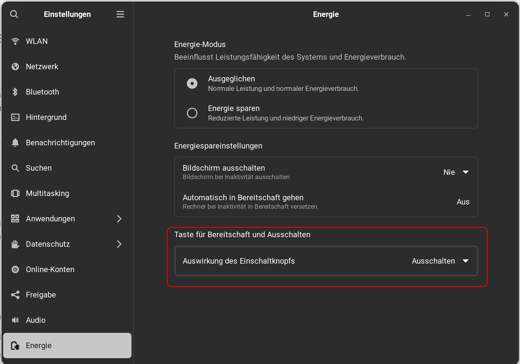

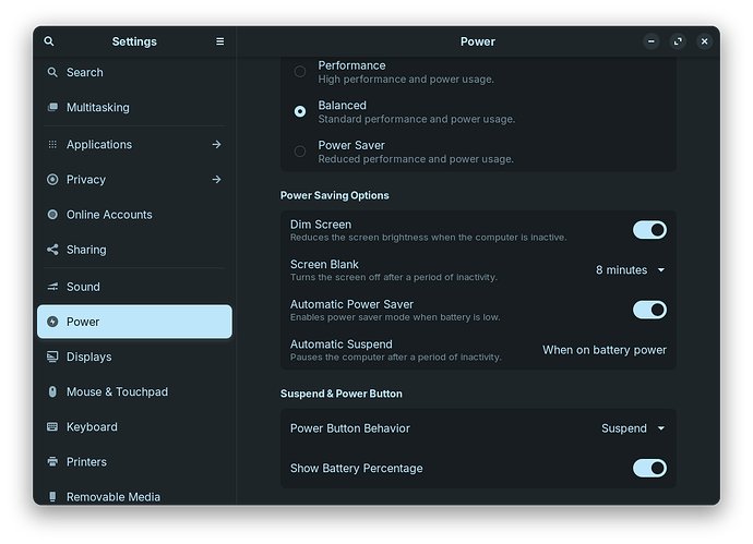

When You go to Settings>Power/Energy how is the Option set up where You can choose what happens when You press the Power Off Button:
It is set to Suspend instead of Power-off. Maybe this is the root of my issue. I will set it to Power-off and observe for a few days. Thanks.
