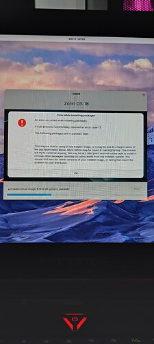

Hi guy's i was hoping that anyone could help me with this problem that im having installing zorin on my acer predator 15 i went the nvidia route and i keep getting this error.
Error while installing packages
It would be grate if someone could help me with this before i install it on my main pc
Repeat the install and do an offline install. Don't connect to internet, don't install nvidia drivers and don't install updates or third party software.
Then it works.
Install the drivers and updates afterwards.
Go to tab Software&Updates > Additional drivers there you can see which drivers are offered for your system.

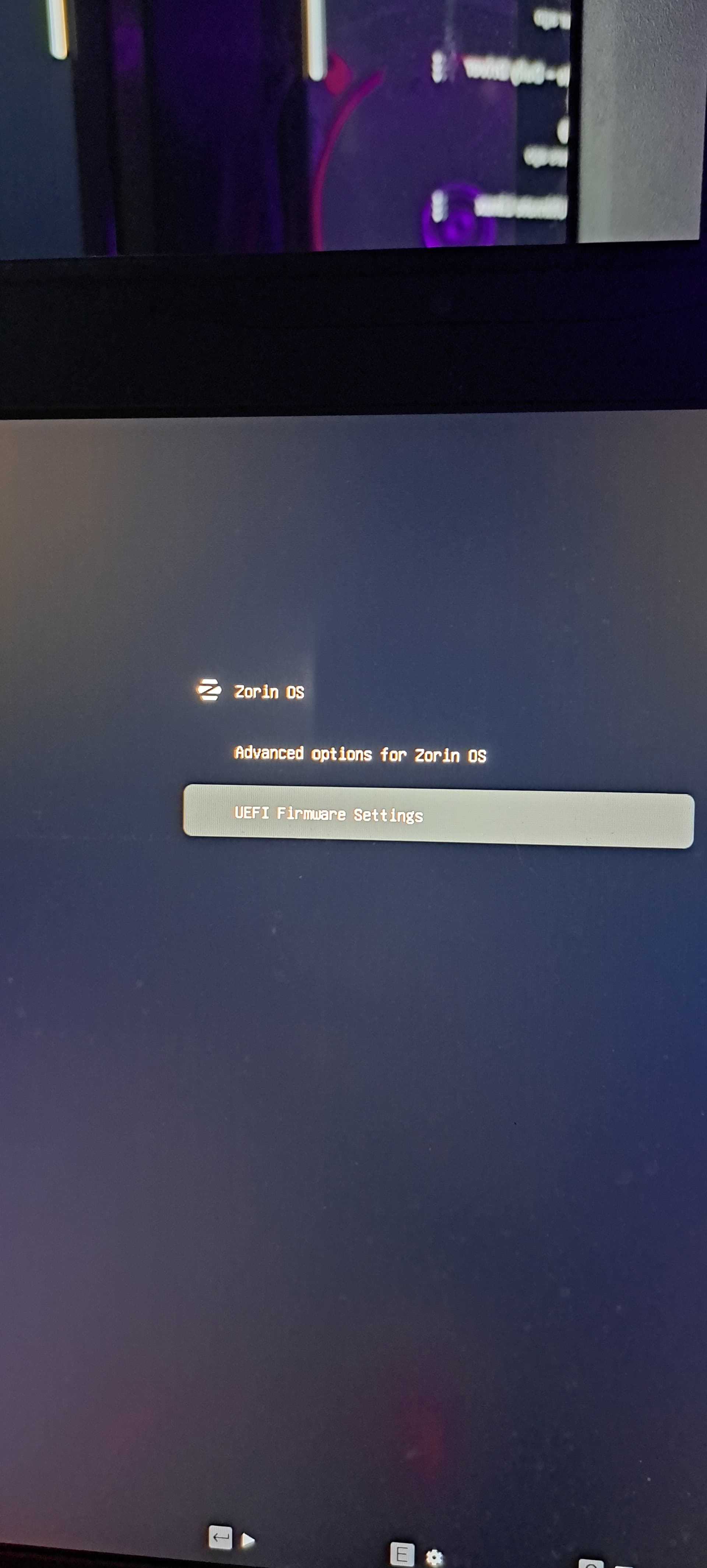

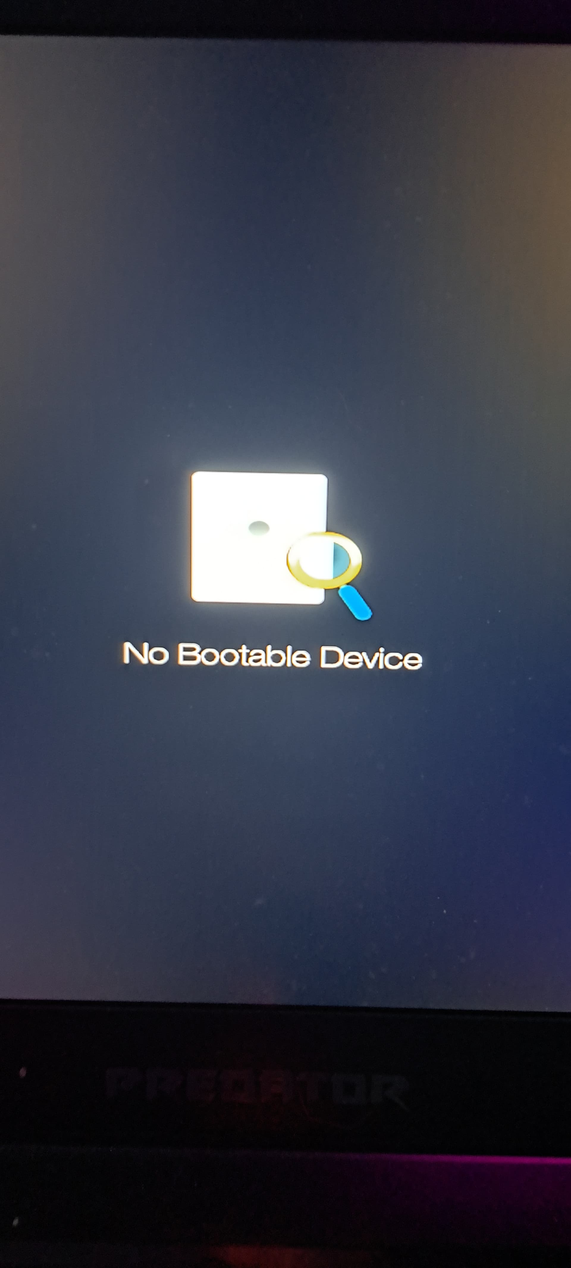

Huh so this just happened
Any ideas why or what i should do
That's typical for ACER. Take a look at the two links what to do now.

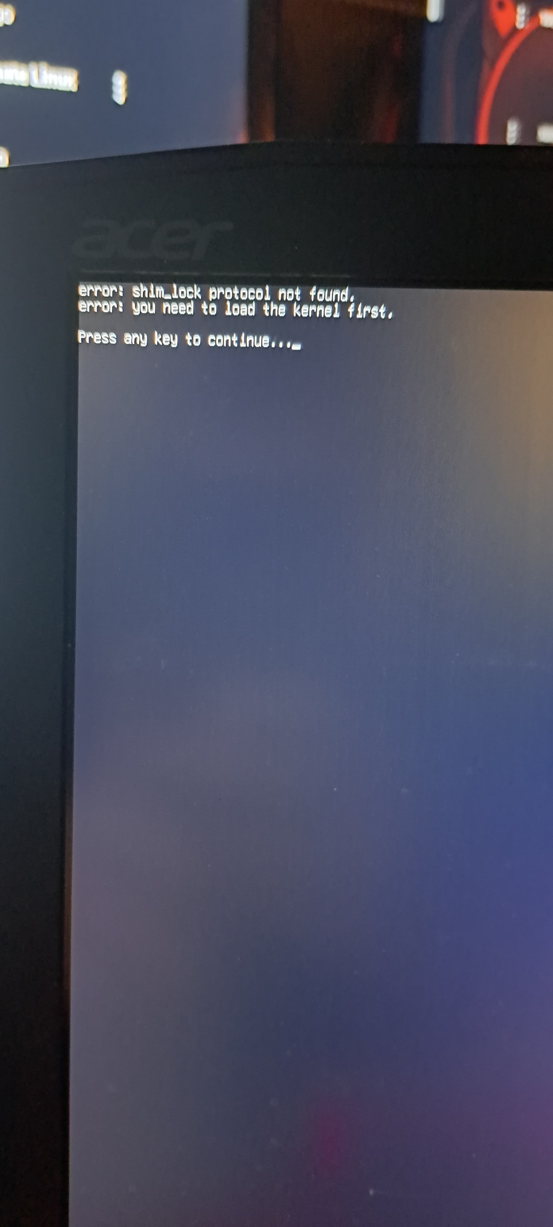

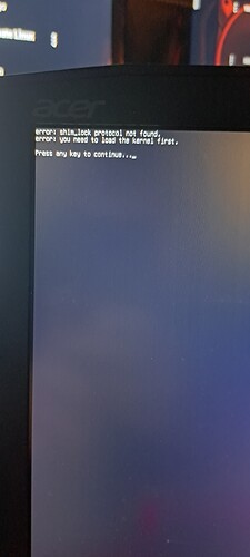

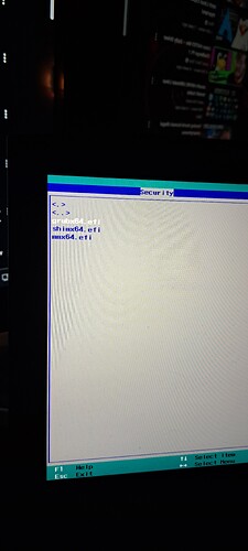

Oki i did that but now i get these props
Try it with disabled secure boot if it is enabled.
Oki but i just read over one of the forms what am i supposed to do in the grub screen?
In the grub screen you normally choose Zorin OS to start it.

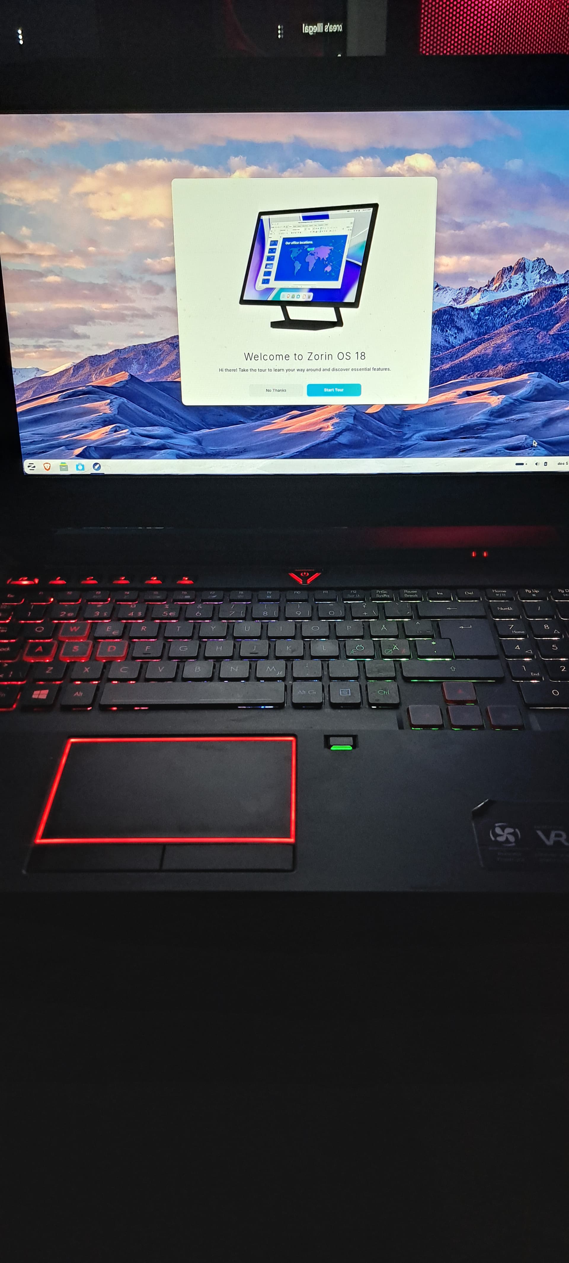

It worked
But do i turn on secure boot again then after i install and update everything
For many users it is much easier to keep secure boot off during Limux use. But you could also create a mok, then secure boot can be enabled. I think the method you used should acchieve the same, but often it is not so easy.
