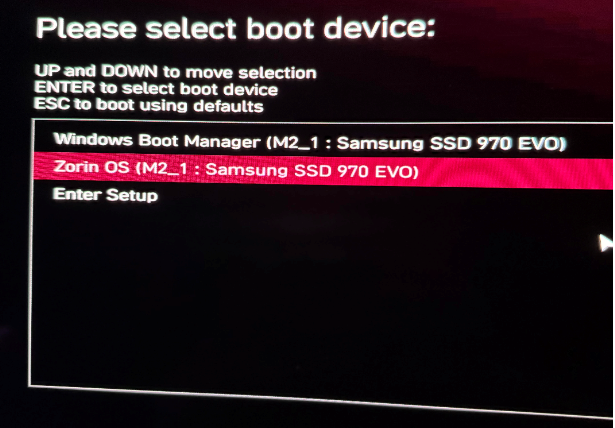

Let's cover the boot location. As stated they are on separate drives but.... Unless this is something I don't know about dual booting Widnows with Linux, I went into my boot screens with F11. Windows and Zorin are listed but they both show the same drive even though in previous image their bootloaders are separate.
Secure Boot is on but for me it's located in the security tab. Had it off during Zoring install as it was suggested but turned it on after install. As for the ability to select a Trusted UEFI file, I do not have that option anywhere in my BIOS. The Zoring drive also doesn't show up in my boot option in Bios. That's probably because it's pointing to the Windows drive based on above image. So, can't reorder boot drives as there is only one.
As stated, I can F11 into boot menu to go into Zorin. It is an option. Not an ideal option especially when I drop Windows. Not sure what the fix is maybe outside fresh installs of both after wiping all volumes and maybe installing Zoring first and see how that goes.

The boot locations was decided by the install but if you go by the second image where I when into the Boot menu with F11, it looks like Zorin is defaulting to the EFI of the Windows drive. However, i did make the change in the Grub file, which you stated should default to Windows but it's already defaulting to Windows as the primary and only boot without interfering with F11. No F11, straight to Windows, with F11 get 2 options to boot from.
