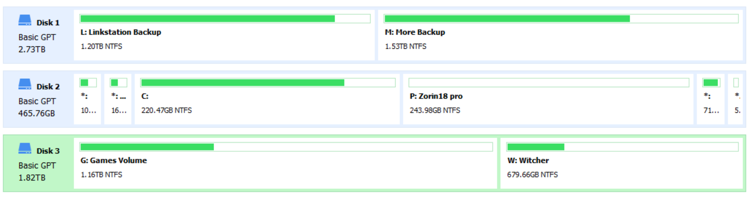

I have 3 physical disks in my pc -
Disk I is a slow scsi phycial disk used as backup mirroring two different sorts of shared remote devices - physical NAS and Cloud;
Disk 2 NVME is used as a system disk and for Windows specific utilities;
Disk 3 NVME used for Games software and programming utilities.
Disk 2 is the logical place to put a dual op.

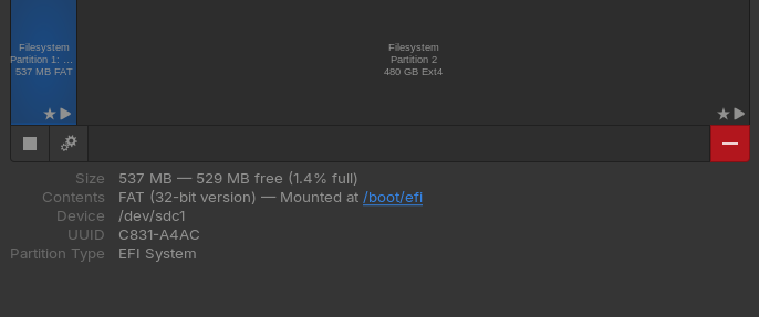

Following the instructions ... When I reach the screen which says "Install Zorin OS alongside Windows Boot Manager - Select Drive the only option I am given is Disk 1 which is the worst possible option.
I have tried with Disk 2 configured with all free space allocated to drive C:, with 250mb of unallocated space, with an unformatted drive P, and with Drive P formatted.
None of these configurations give me the option to use Disk1 or Disk 2.
Finally, I tried installing to Disk 1. This went through the whole installation process but when I rebooted nothing had actually ben installed anywhere - it was like a "phantom install".
So I merged Drive C with Drive P and tried again using the Zorin install something else routine. Another phantom install. And the free space created by the install now shows as "unallocated". Format as EXT4 and try again.

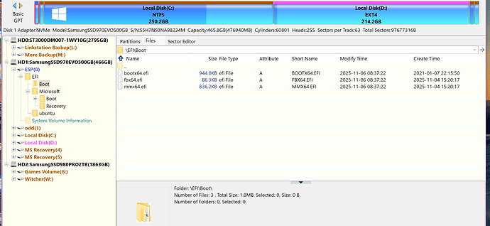

UEFI still only sees Windows11 boot.
I ran the routine to fix the boot loader but still no grub.
I have attached snapshots.

Based on Your default Setup where You want use Disk 2 as the Installation Drive:
Use in Windows the Disk Management Tool and create on Disk 2 free Space for Zorin (which You seem to have already done). Create the bootable USB Stick with Zorin on it. Because You are on Windows, Rufus is a good Tool. Choose in Rufus on the ''Partition Sheme'' Option GPT.
Then start the USB Stick. During the Installation choose the Installation Type ''Something else''. Here You create manually the Partitions. You have to do 3 Things here:
  1. Choose the Disc where You want install Zorin (in the upper right Corner)
  2. Take the free Space that You created earlier and give it the Mount Point / and format it to ext4
  3. Under the Option ''Device fo boot loader installation'' choose in the Dropdown Menu the Option ''Windows Boot Manager''

I've done these things multiple times but the only result is Windows bootloader is screwed (I've lost the correct drivers for keyboard and mouse in PE).
I can force the PC to boot to the GRUB prompt but the bootloader for Zorin also appears to be screwed, which is why I've included the Ubuntu repair report.
I can deal with the Windows stuff, it's just a little inconvenient to have to fix an OS that I want to junk anyway, but I don't know anything about how to fix the problem with Zorin.

Hi there.
I have not been able to set things up the way you wish to either. Select your choice of OS from the Bios Boot List.
Good suggestion to remove all other drives 'temporarily' and make unallocated space ahead of time.
However, even though I create all three necessary partitions efi, root and home on the only installed disk, and booting from that disk works when on it's own. When the windows disk (which is an internal nvme) is seen by the bios the zorin disk is ignored.
Booting from the Z USB 'live' and running the 'boot repair' only results in the report saying that the "nvme is locked" and leaves the pc unbootable.
If start another install with the nvme being 'seen' during the installation and choosing the nvme drive as the "location for the boot device", the install completes up until the point where it needs to restart to complete the installation process.
There again I get the nvme locked message, and I need to fix the windows booting again.
Furthermore, if I choose the 'install along side' an OS, I get the same result.
Perhaps I have two separate issues.
Bios doesn't seems to recognise the zorin disk's efi partition, so doesn't show up in the bios boot list.
Anyway, good luck with your install and please keep this updated with any more info, or successes.

This desktop was a ground up build in January 2021 with a clean install of Windows 10 Pro, then rebuilt as Windows 11 Pro as soon as it was available. Always efi. Always kept up to date.
There is some real weirdness here.
The last release of Windows 11 is seriously bugged. So much that I have just finished applying manual patches released by Microsoft to enable access to WinRe to at least take a look at repairing the Windows Boot. The automatic repair says it has corrected some disk IO errors which is a surprise on a lightly used NVMe but I'll take a further look into this along with repairing Grub.
mbr2gpt fails with typically unhelpful messages. There must be a log buried somewhere!
I have no idea what else doesn't work following 25H2.
Thank you again.

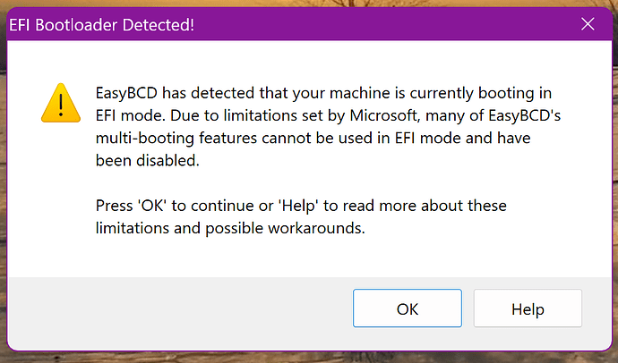

Good thought. EasyBCD is an old friend but apparently no longer :slight_smile:
Take a look ...
Did You already checked that YourBIOS is in UEFI or Legacy Mode? Another Thing would be the Drive itself. On Your Pictures above stands that it is in GPT ...
When You start Zorin from the USB Stick in Live Mode and open GParted or Disks, what show these for the Drives?
Was the SSD a used SSD?
Wait...
It was used.
Think it retained the old Win 7 Bootloader?

I've now got Windows 11 and Zorin 18 to co-habit peacefully.
I ran the Zorin 18 install with Secure Boot and TPM turned on and 3 disks installed in the PC.
I used the install routine to split the system disk.
When I got to the part that says where do you want to put the Boot I specified the current sector with the Windows Boot Manager, despite the warning not to.
