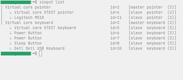

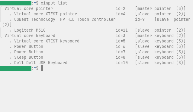

This is my input list with it attached:
And this is without:
It looks like the touch screen is id 9
