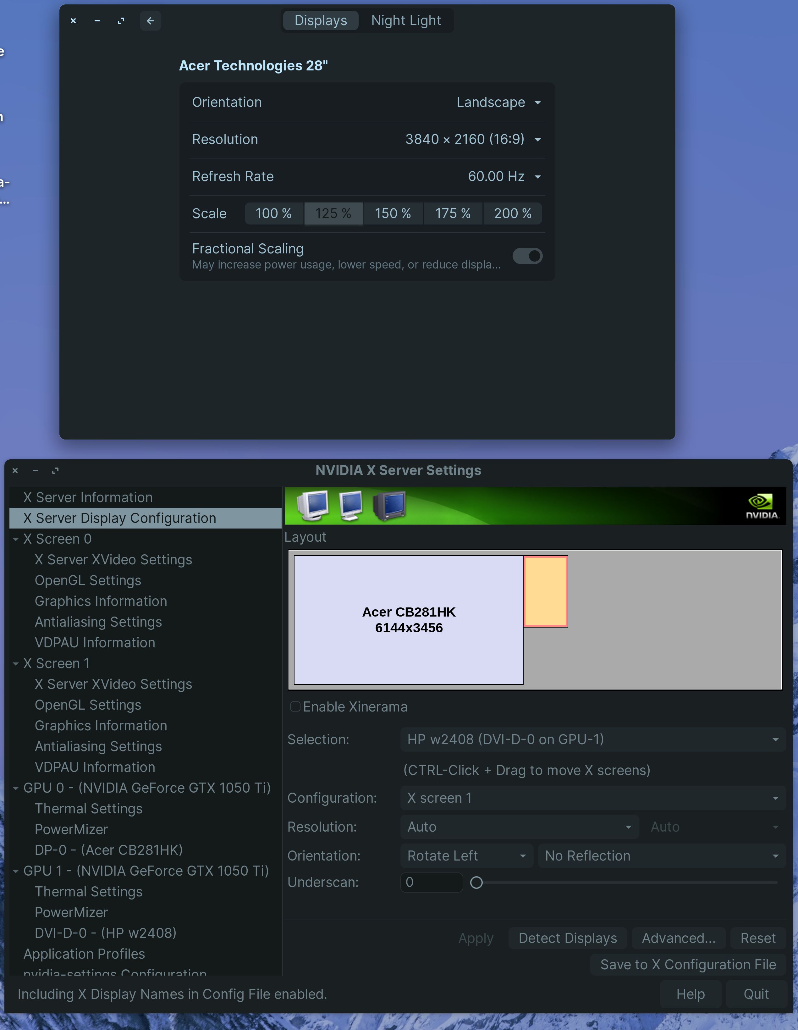

Dual NVidia 1050TI in DellT7910. 2nd monitor no desktop?
This probably isn't a Zorin problem, but an NVidia one, but since I'm running Zorin 16 Pro I figure I would ask here.
When booting from USB, both screen showed up, but after a full install the monitor on my second 1050TI won't allow any desktop.
It's on, and I can drag my mouse onto it, but the mouse cursor turns to an"x" when ever I drag itno that monitor.
Zorin's display settings
HELP!!!

Well, I got little update. i have both my monitors working, but they are both off the primary graphic card.
The second card isn't recognized at all by Zorin Display, but is seen by NnVidia x Server desktop.
I was using DisplayPor ton the main card, and DVI on the second card.
HDMI on the second card didn't work either,
I'm going to get some tech spec and post back.
I wonder if this has anything to do with the T7910 being a Dual CPU machine. I have the second 1050TI ob a slot dedicated to the second processor.

Just bumping this since my second graphic card is still not hosting any screen.
Second card?
Did you replace the nVidia 1050ti? Or is the second of the two you have?
No replacement. Just trying to get both GT1050TI working a the same time.
