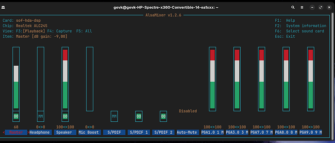

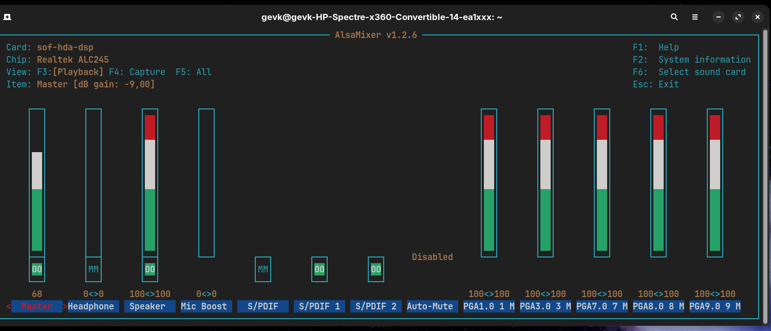

In alsamixer, I get quite a few channels, but not sure whether those are the additional speakers and how I would be able to address them.
Can you install qasMixer and see what that shows? I also wonder if it is a kernel issue:
qasMixer just shows a master audio and mic slider, that's it.
Not even left or right speakers or hdmi outputs.
I have tried repinning with hdajackretask, but that locks up whatever I try... so cannot really experiment there.

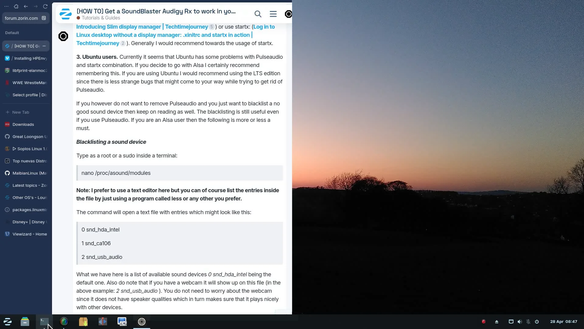

@geevk Hi, I have created a video for you regarding qasMixer which explains what you have to do to show multichannel. You need to select View | Card:
Sadly, no sound because I forgot to include recording source!
