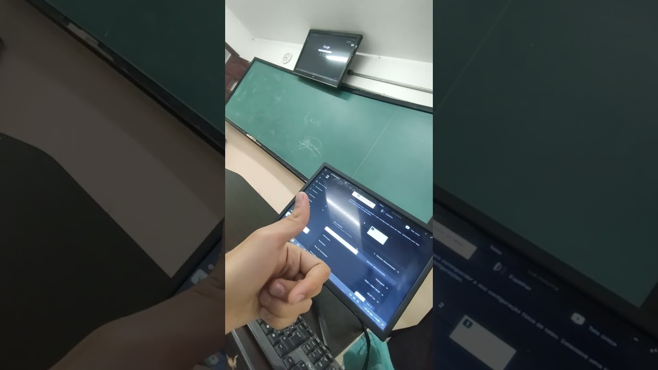

I have Educational Zorion installed in 2 schools,
i am having problem with teachers, when i try to display the screen on only one monitor. could someone help me to correct this error.
video showing the error:https://www.youtube.com/watch?v=cAV5APOujbk

hello, I redid the video from another angle, as you can see using (win+p) the last two options do not work. Also when changing to appear on both screens it has to change every time from 60ZH to 30ZH
I made the video again, take a look
when changing the screen, depending on the application it appears on the monitor behind, making the teacher not see what is happening, and making everyone angry.
I needed everything to appear on the main screen.
also when teachers want to use only the screen (without the tv) it is not possible, as I showed in the video.

Based on the videos you posted, it appears that you're using a desktop PC which doesn't have an internal display. Internal displays are only present on laptops and tablets.
Because both of your monitors are external displays, they both function the same.
In order to disable one display and not the other
  1. Open the Zorin Menu -> Settings -> Displays
  2. Click on the "Single Display" option
  3. Select which of the displays to use below
  4. Click "Apply"
You should also have quick access to the Display settings by right-clicking on the desktop and selecting "Display Settings".
