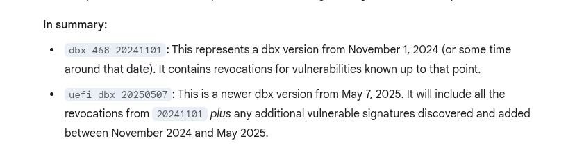

Before was the dbx version 468
Since fwupd snap is the version 20241101

Nice! I've switched to the snap version too and while it still cannot update the capsule on my board it got rid of the update from the list. It's also now showing my board has the latest DBX but nothing actually got flashed by it
