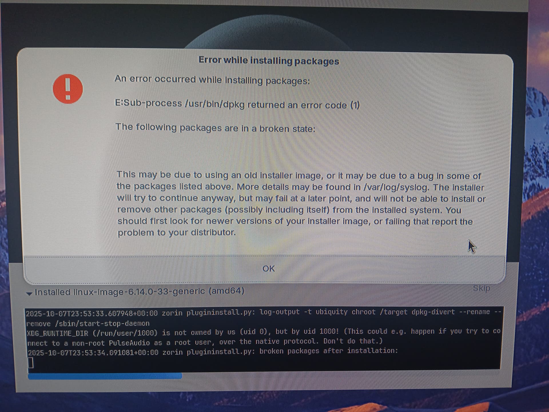

Error for install Zorin 18
The install zorin 18 have issue, when I try install the version with drivers nvidia and updates option actived.
The error is:
I only try again for report this for Zorin Team.
Maybe this have a solution.

The system installs normally when the option to download updates and third-party drivers is disabled.

@zenzen and @Ponce-De-Leon As mentioned in the thread, I only reported the problem. If it's a bug with a fix, it would be helpful to share the log and the error occurring during the installation process.
Remembering that my graphics card, processor, and other hardware are newer, the system is currently running perfectly.
I installed the system with the driver download and third-party driver download options disabled.
I then downloaded the NVIDIA driver through the software resource.
