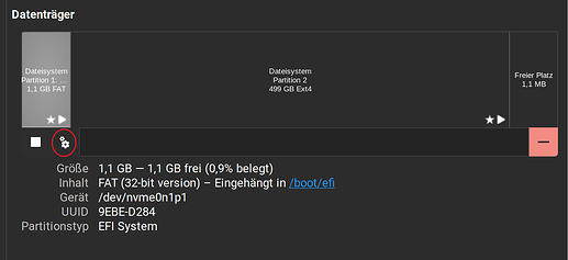

When You open ''Disks'', choose the Drive and click on the Settings Button:
You should see a Settings Overview. And there is a Mark of Mount on Start-Up. Is this active?
