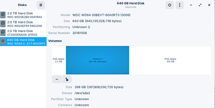

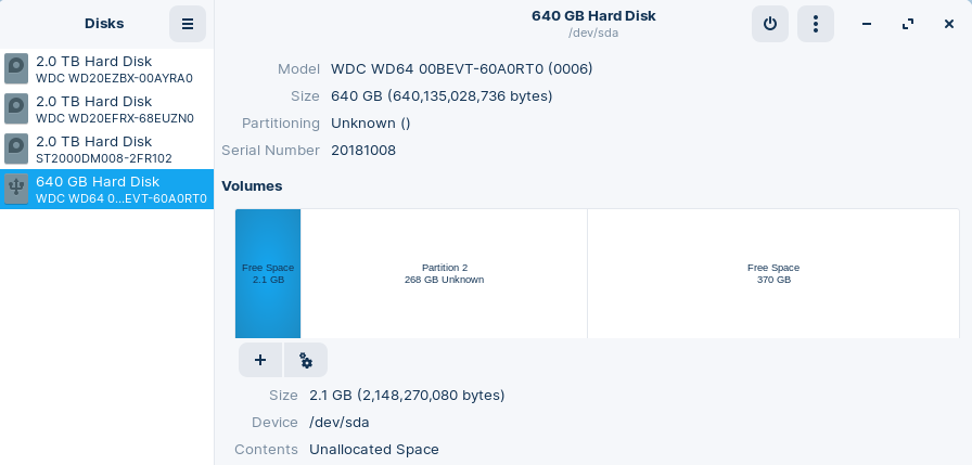

Am wanting to use this 640GB WD disk for backup so I can up to 17 but I am getting this message when I want to format it.
Error synchronizing after initial wipe. Timed out waiting for object (udisks-error-quark,0)
In Disks it shows as 640GB - Partition 2 286 GB Unknown - Free Space 370GB
/dev/sdd Unallocated Space.

Would you be able to include a screenshot of your drive from within say Gparted? Select the drive and then we can see the partitions and what's going on with them.
Since you say the drive used to be for Windows, I'm assuming that it's presently formatted as NTFS. In Linux land we prefer not to use that, as it can cause a whole host of issues. If you'd be alright with wiping the whole drive, you could reformat it into something more usable for Linux (such as ext4) and should be good at that point. But the screenshot of the drive in Gparted would help us to see more.clearly what's going on.
In addition to @applecheeks37's suggestion to use Gparted, which I agree would be better for formatting; Please ensure that the drive is unmounted prior to trying to format it. A drive can be wiped while mounted (with caveats and is unsafe), but cannot be formatted while mounted.

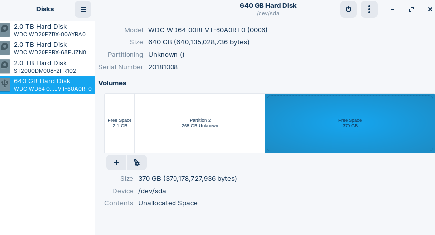

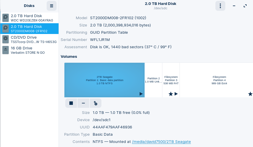

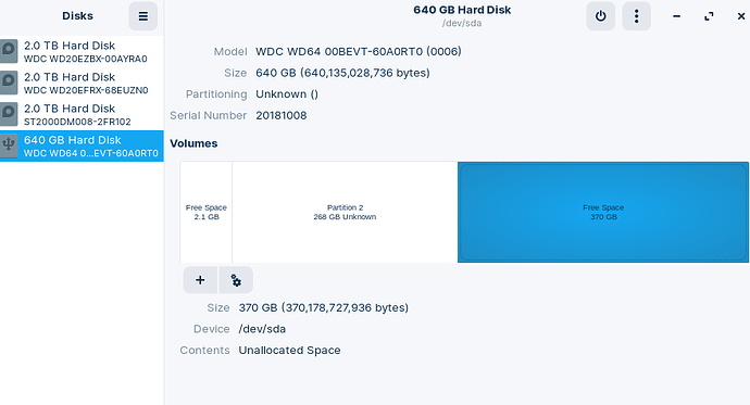

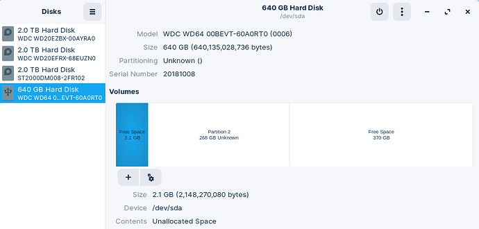

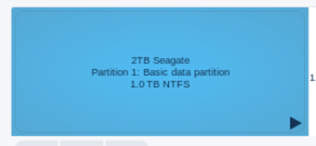

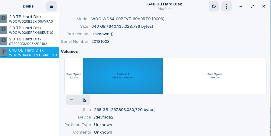

Many thank guys. I have attached 3 screens of the 3 partitions of the 640GB disk so you can see what goes on.
Also a df -h list.
Is that 540 mounted yet?

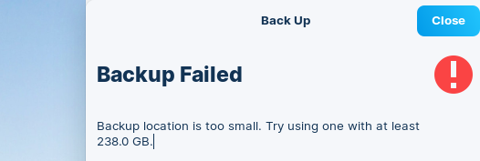

I had the Z Backup working for years then a few weeks ago after a PSU problem, it now will not back up. There is still plenty of space on the separate backup drive.
As I write I changed the Backup location but it needed another 238GB so went back to the original and now it gives me this.. so maybe (hopefully) it is correcting whatever was wrong.
I will be back !

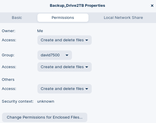

Oh no.. didn't work.. just got this error opening file.

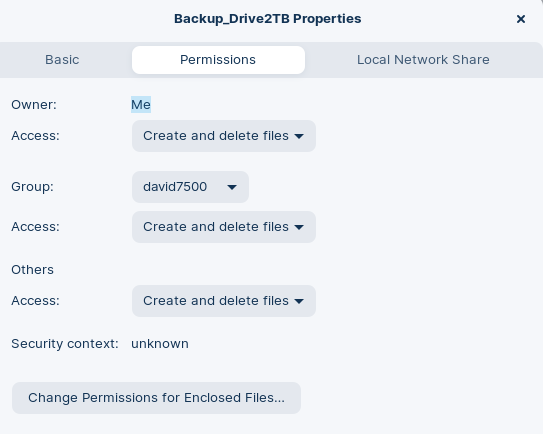

Checked Permissions and see this.
You could check if fast startup in Windows is enabled. If yes, please turn it off. Perhaps it helps.
