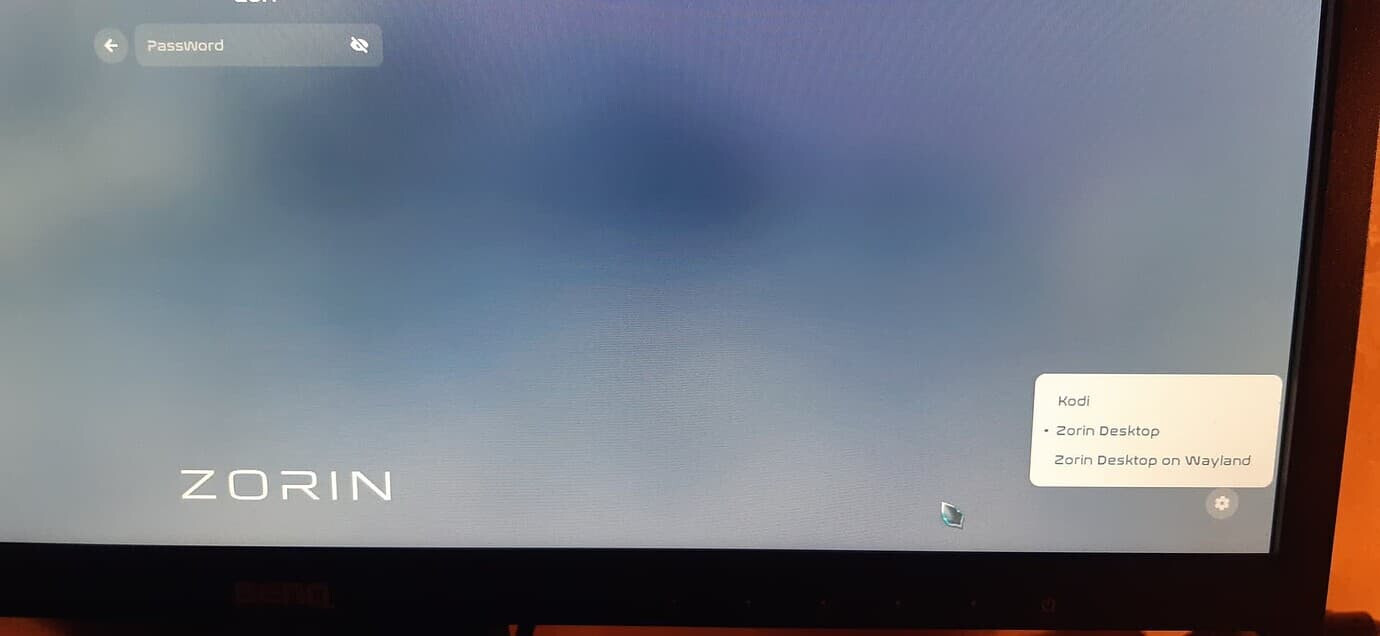

(2) When your at the login screen, click on your name, then a gear :gear: icon appears, click it, and switch to Xorg, AKA, Zorin OS Desktop, not Wayland!

2 -> Desktop environment, I'm currently running x11, not Wayland, and I don't see the gear you're talking about on the login screen :confused:
