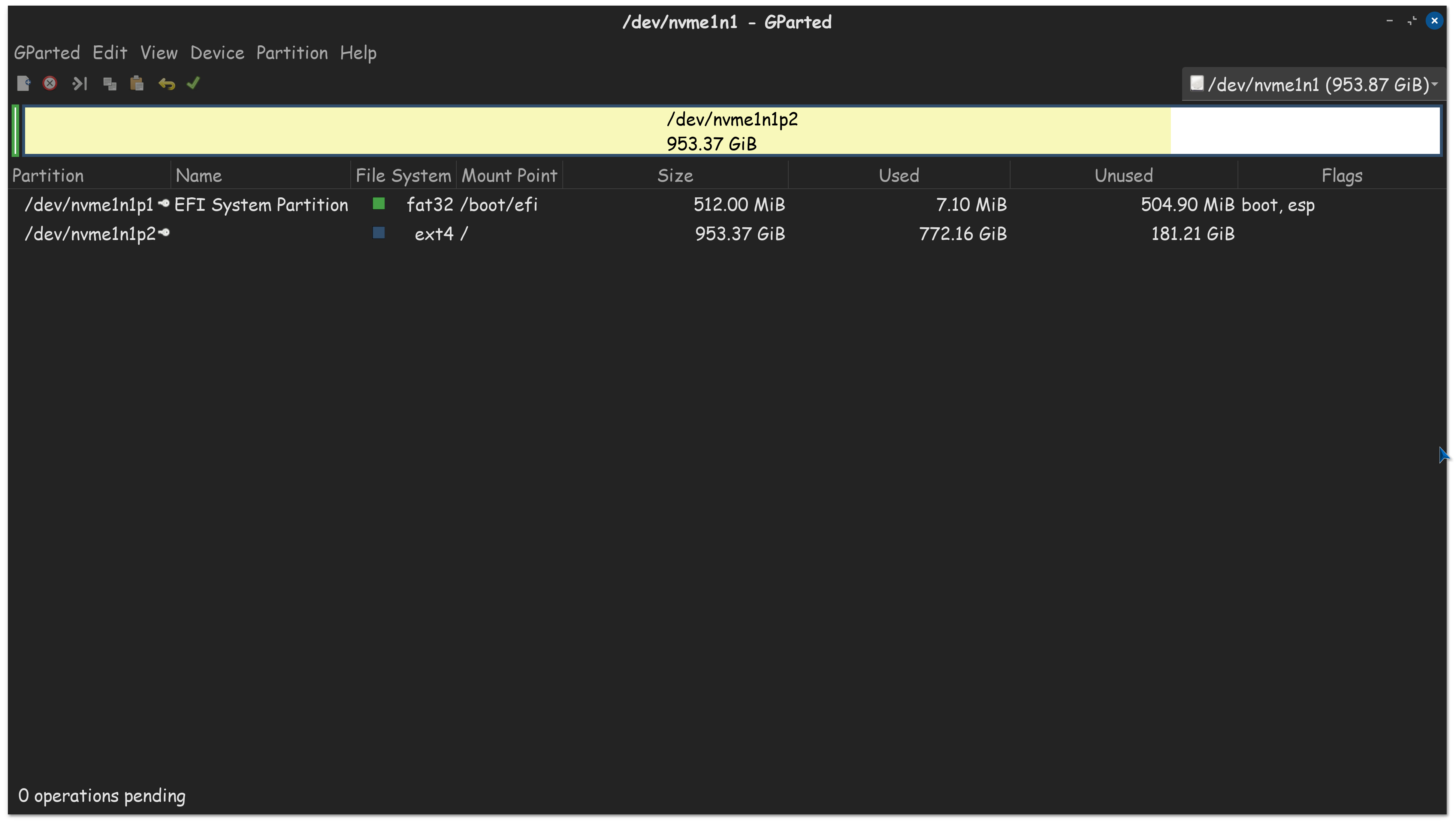

Due to the error you received, we need to see a screenshot from your Gparted APP. Once the APP is loaded up, you will see a drop down box on the upper right side. Click on it, and choose the drive that has the OS on it. It will be the one that says BOOT EFI once selected. My screenshot for reference.
That is the drive I have Zorin OS installed on, that has my BOOT EFI partition on. What were trying to discover are 2 things, how much space does your entire drive have left on it, and whether or not your EFI partition is maxed out or not.
