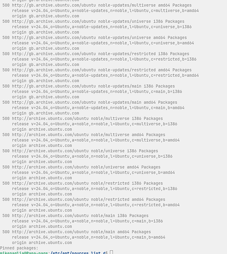

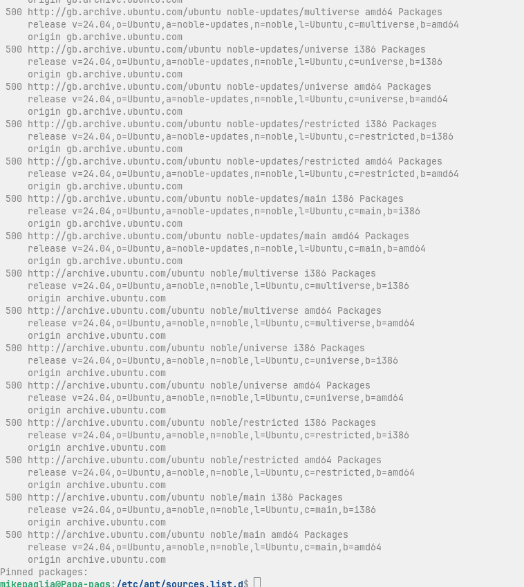

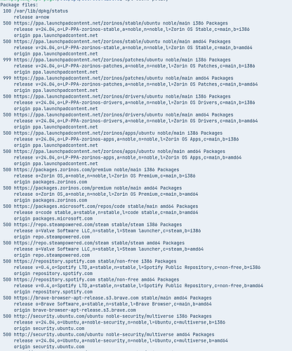

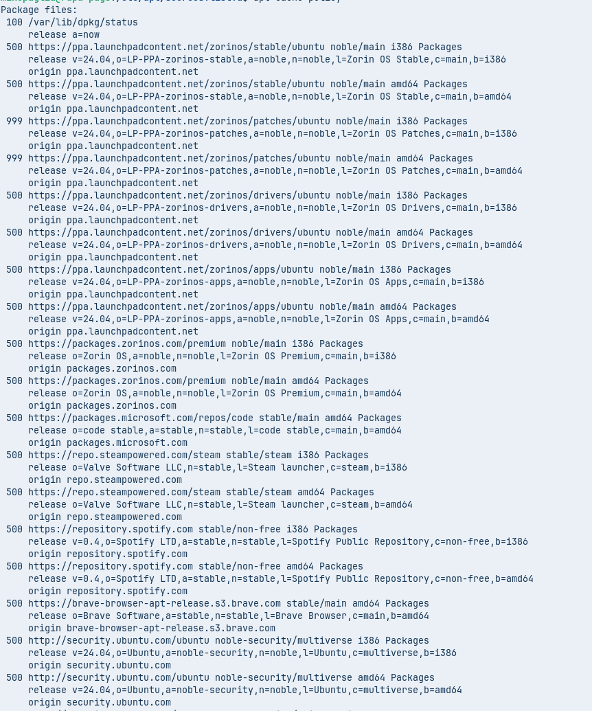

Could you give me the output of
apt-cache policy
This forum only allows for 5 links so I cannot post a reply with the output!

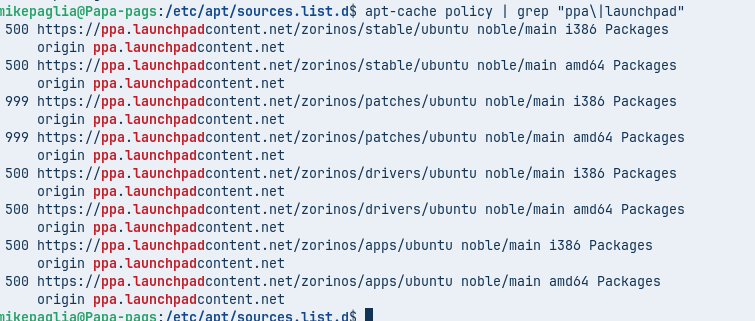

apt-cache policy | grep "ppa\|launchpad"
