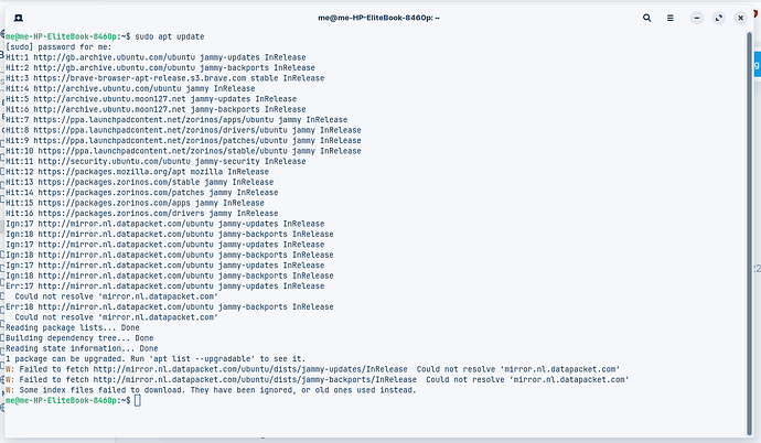

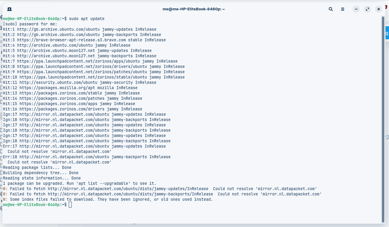

Sudo apt update screen attached.
I suspect this is something simple where its failing to download maybe outdated repository info but my skill level isn't high enough to fix it myself. Any ideas?
Does show a package that is upgradable.. have you looked to see what it is?

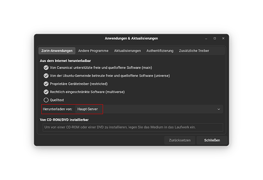

Go to Software & Updates and there change the Source to ''Main Server'':
then open the Terminal and type sudo apt update && sudo apt upgrade

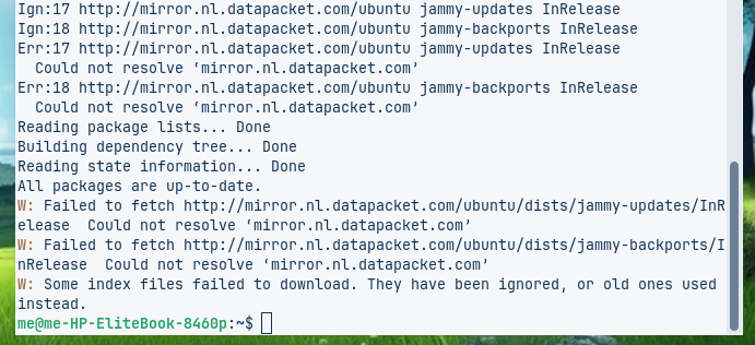

I Changed to main server and ran
This will update the OS but doesn't clear the errors, which appears to stop me updating the the OS to Zorin 18 (which is the overall aim here).
You have changed to Main Server but You have still as Server morror.nl.datapacket. Maybe it is neccessary to change that manually. Unfortunately, I don't have a Zorin 17 Install. So, I cant give You the right Sources Files ...

The nl can be manually edited from the sources.list file.
But the error is for About DataPacket - Superior dedicated server solutions | DataPacket.com
Not for Zorin OS repositories.
Yes, it seems to be a Mirror Server for Ubuntu. And that doesn't seem to run. So, my Idea was to replace it with the Ubuntu-own one's. But I don't have a Zorin 17 Install. So, I can't offer the right Adresses. that is the Reason why I aseked for someone who might still have it.

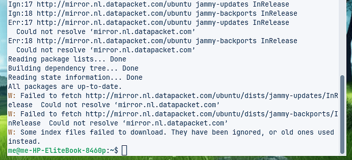

The errors are again:
Err:17 http://mirror.nl.datapacket.com/ubuntu jammy-updates InRelease
Could not resolve ‘mirror.nl.datapacket.com’
Err:18 http://mirror.nl.datapacket.com/ubuntu jammy-backports InRelease

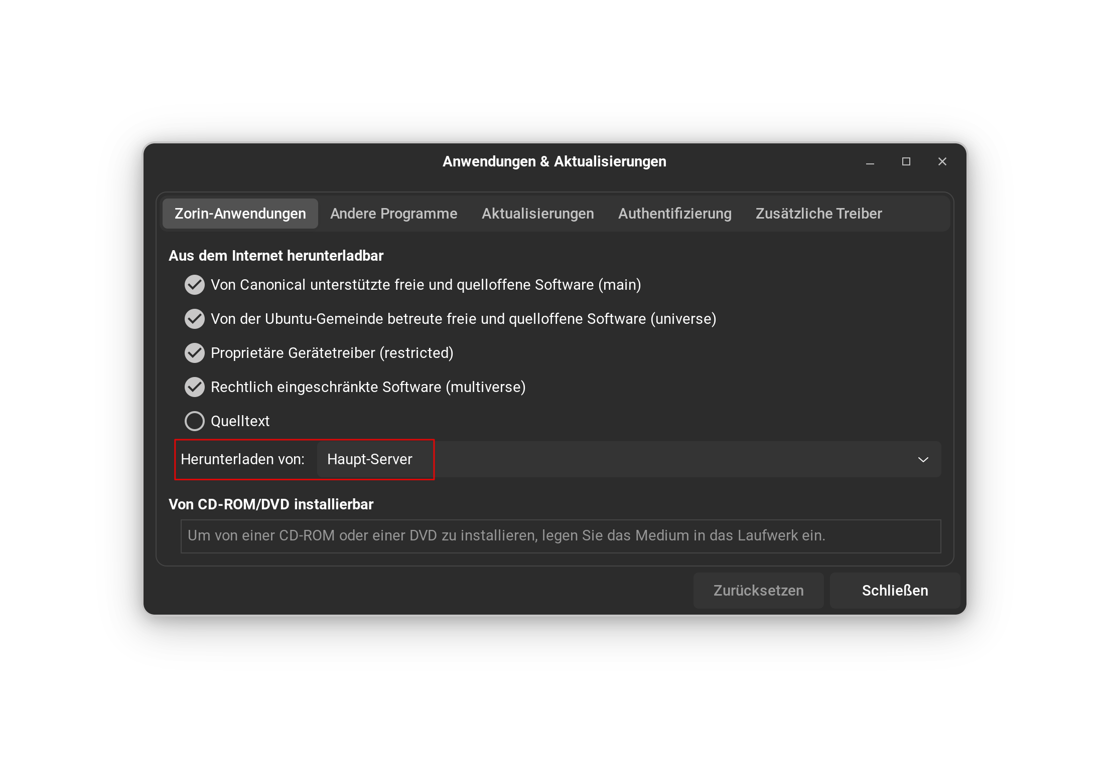

And screenshot of similar entries in other software list:
I wonder if this is relevant, it says it is 'broken':
Try unchecking the 2 unsupported updates
