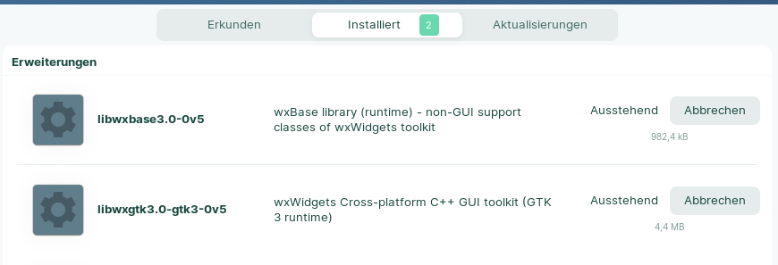

It looks like libwxbase3.0-0v5
and
libwxgtk3.0-gtk3-0v5
are needed.
I determined this by grabbing a wget of veracrypt-1.24-Update7-Ubuntu-20.04-amd64.deb and launching the .deb in gdebi. I may already have other dependencies installed that you do not... so this is kind of a shot in the dark.
Here are the .deb packages for the two above:
http://archive.ubuntu.com/ubuntu/pool/universe/w/wxwidgets3.0/libwxbase3.0-0v5_3.0.4+dfsg-15build1_amd64.deb
http://archive.ubuntu.com/ubuntu/pool/universe/w/wxwidgets3.0/libwxgtk3.0-gtk3-0v5_3.0.4+dfsg-15build1_amd64.deb

Thanks, but it did not help.
