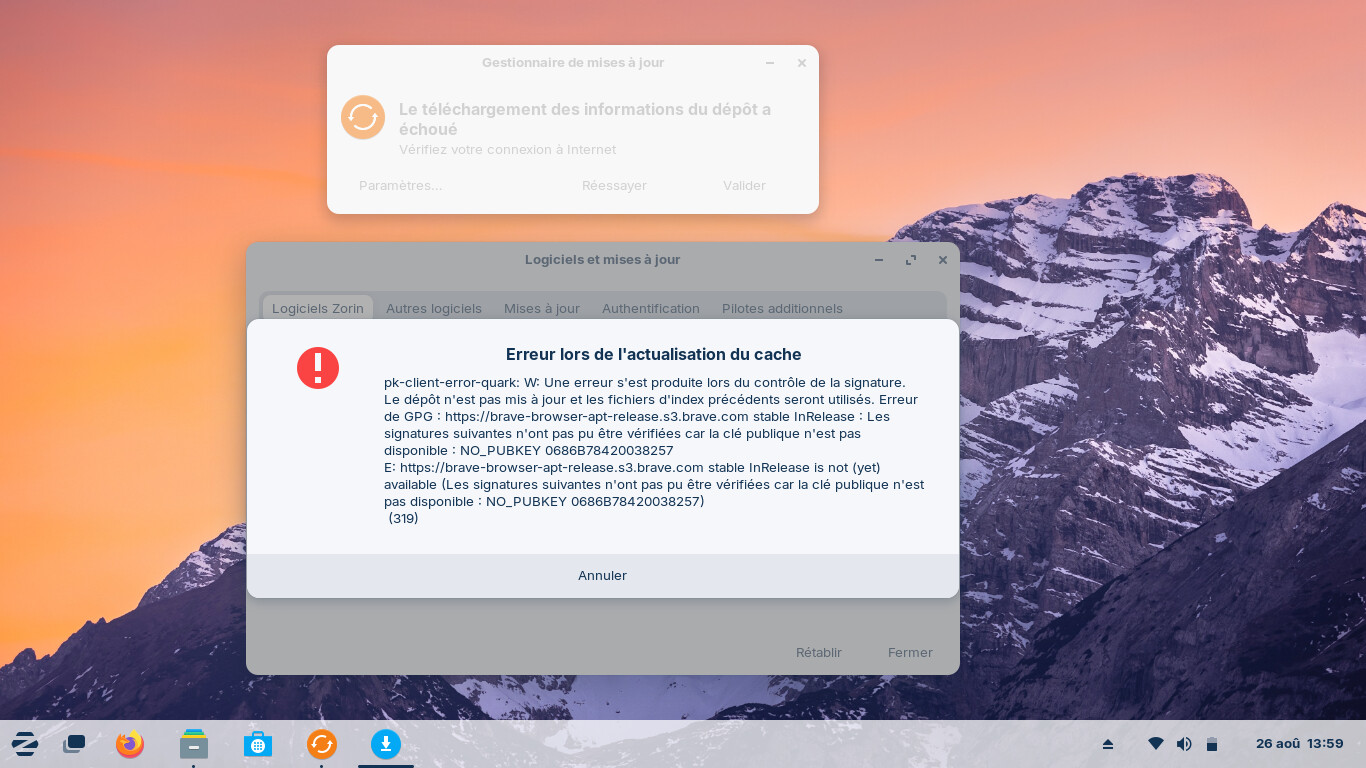

Was it a Warning Message about Architecture?

You have forgot to delete the Key for the Repo, but that isn't important so much now. You write from an Error Message. Do you know what Message that was?
I know, that there can be an Error because of the Brave Repo. In theri Description how to add the Repo is a little ... Issue with a missing Value.

I forgot the exact wording, but it popped up while I was updating the system via Software Updater. Said something about not being able to download from a repository. Didn't say which one. After I dismissed the message, the updater went ahead and finished the remaining repository checks. Thanks for asking.

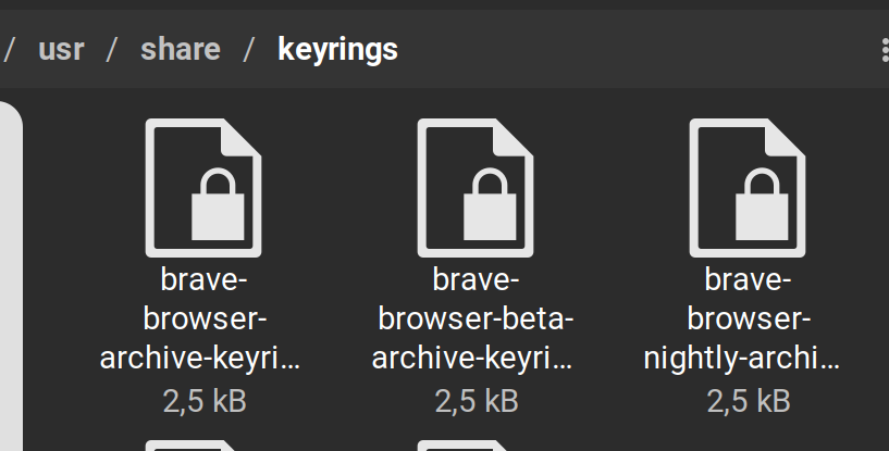

The Brave GPG Keyring Files are under /usr/share/keyrings/
I don't see them. Nothing. Just Ubuntu keyrings. Not gonna mess with these.
Should be this:
But when they gone, okay.
Yup. Don't see nothin' like that. They GONE. :slightly_smiling_face:
