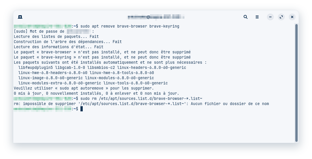

sudo apt remove brave-browser brave-keyring
sudo rm /etc/apt/sources.list.d/brave-browser-*.list

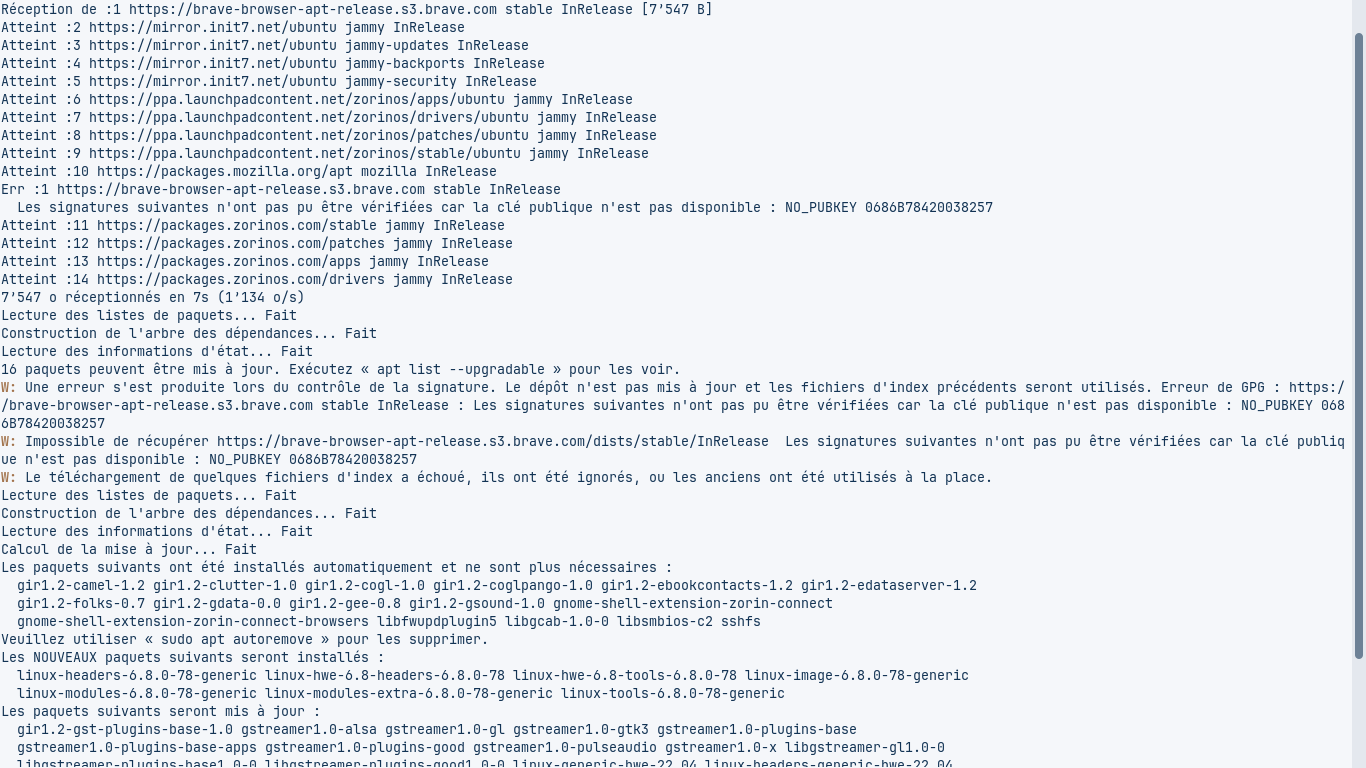

I think this is just an unfortunate coincidence, as there might have been an update running when you uninstalled Brave, either shortly before or after, when the repository wasn't removed.
Thank you for your answers.
However, I think that in this story, the error message is not the most problematic, but the fact that it blocks all updates.
It would be good to have an update system that accepts fault tolerance.
When You open the Terminal and type sudo apt update && sudo apt upgrade what Output do You get?
So, were you able to update over the Terminal or did it stopped? It isn't on the Picture. But so or so, You have to remove the Brave Repo. @Forpli arleady posted You what to do:
One Addition to that from my Side would be to take a Look in /usr/share/keyrings if the Signing Keys for Brave are realy deleted and then make a sudo apt update to refresh the Sources and make the Remove affect.

Please remove the ~ at the end of
Otherwise the name is unknown.

Sorry, a copy-paste problem.
That's great!
The graphical interface updates work again.
Thank you very much.
