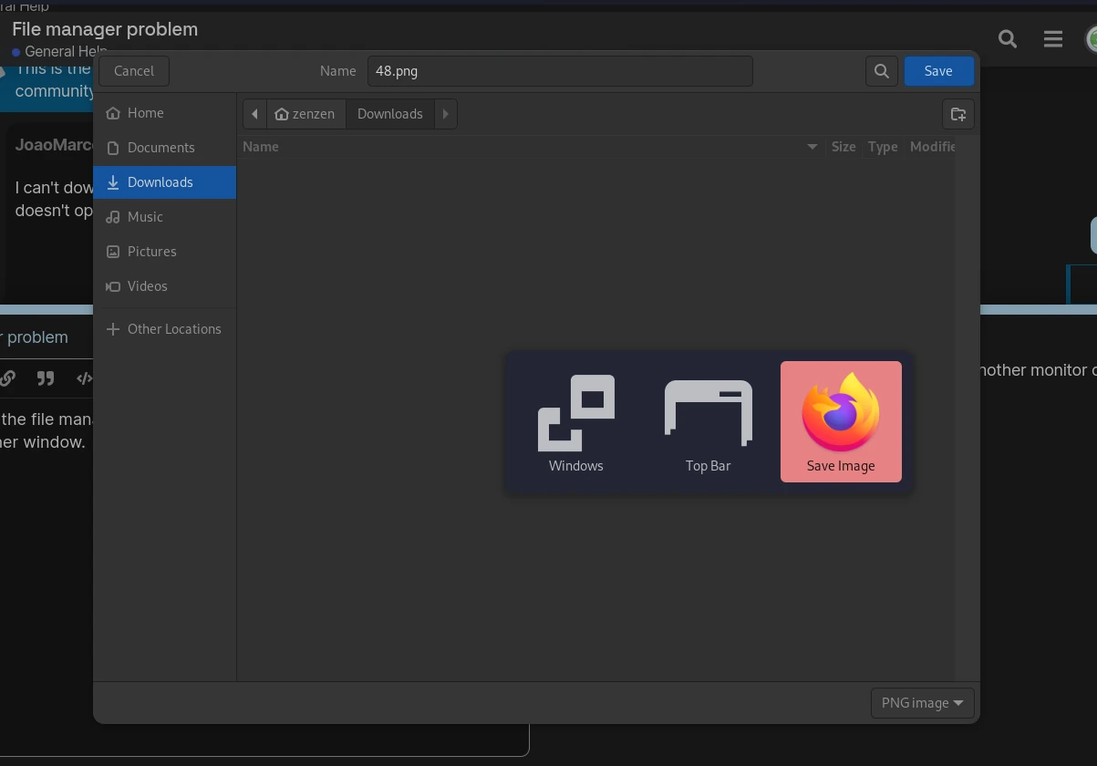

Make sure that the file manager window doesn't open on another monitor or even under some other window. You can press Ctrl+Alt+Tab to switch between different active panels like dialogs as shown here:
Very good suggestion.
On MacBook, it can happen where the system thinks that there are Two Monitors even though there is one monitor and it opens the Save As dialog on the other non-existent monitor. A configuration change is needed to resolve it.
