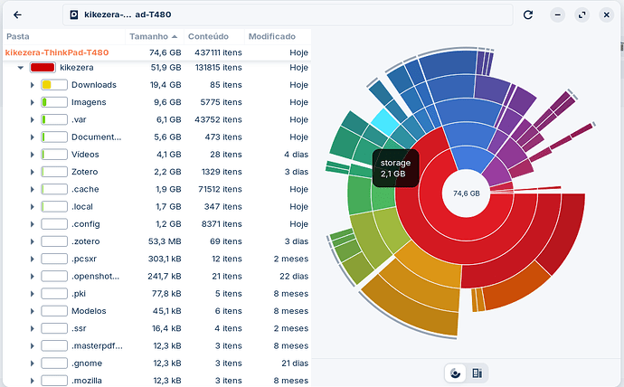

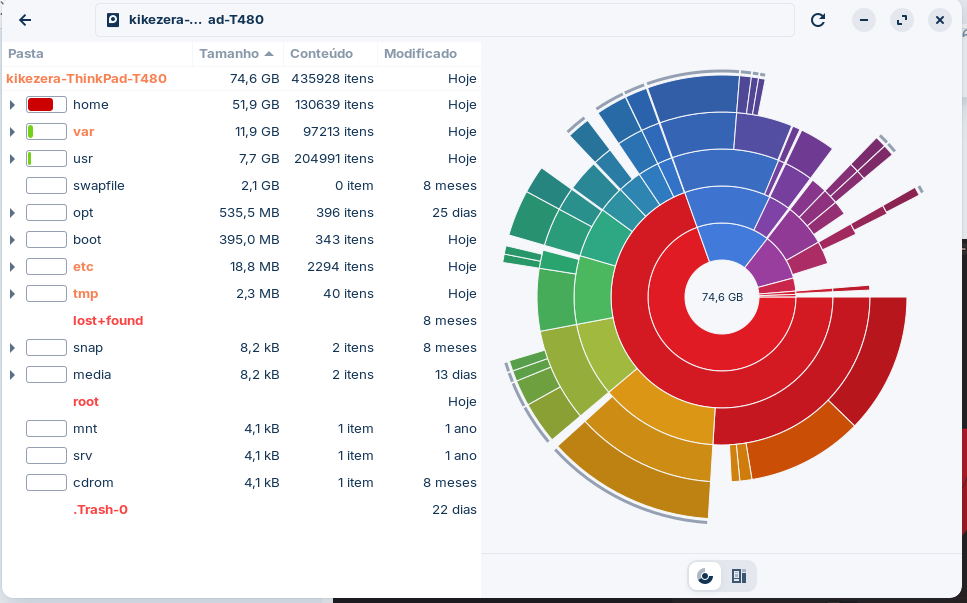

I suggest trying Disk Usage Analyzer (preinstalled) to have a preview of the memory usage.
When you hover over a section (which is a folder) it shows its size and subfolders names.

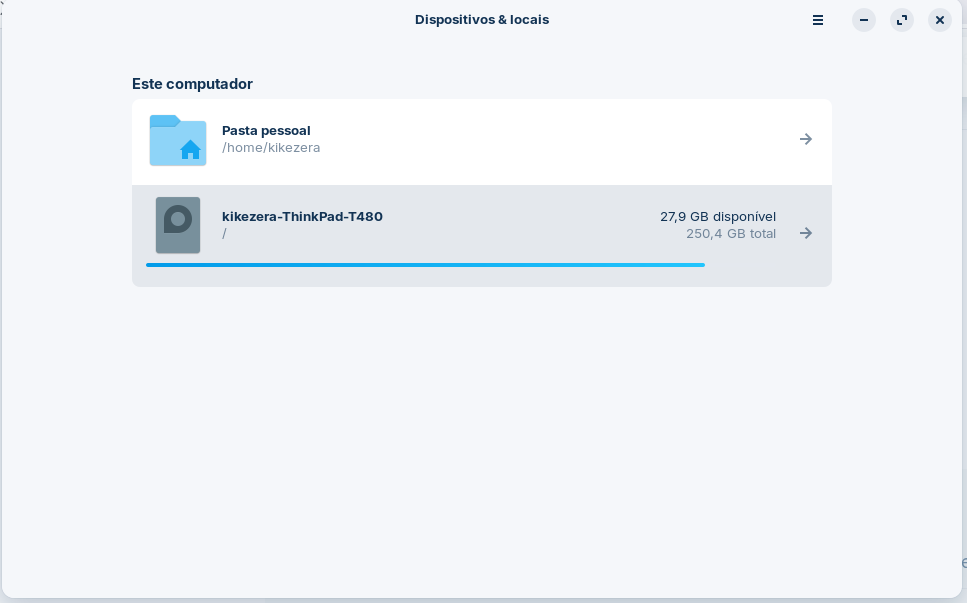

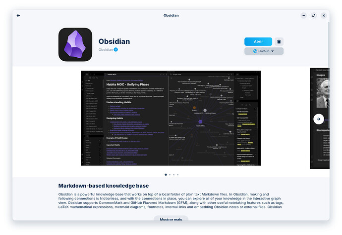

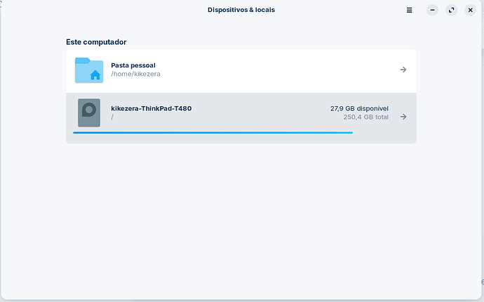

None of the solutions worked. When i open the disk analyzer it says I only have 27,9 GB left but after it says I only used 74,6GB. I do have many flatpacks installed but I don't understand, in the Programs app the flatpack version of the apps always has the Zorin ✓ shouldn't I be choosing that? And i searched but no apps seemed to show a .deb version but only snaps. Is that better?

When You look at Your Picture with the Disk Analyse, You see that the big Folder is Your home Folder (51,9GB). What have You in there? A lot of Movie's, Music and Picture's?

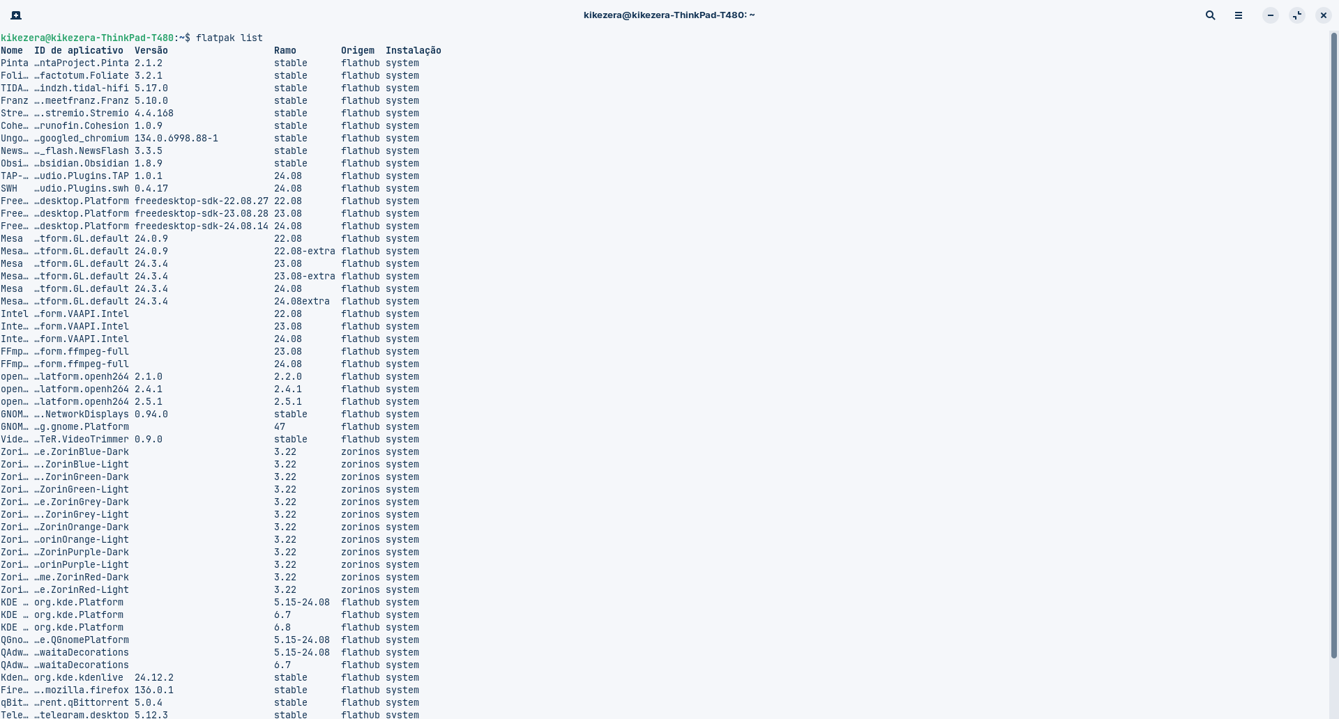

When You type in the Terminal flatpak list what Output do You get? this command shown You a List of all installed Flatpaks. And when You wrote that the Zorin Option is marked: are both Marked? I mean Flatpak and the Zorin APT Package?
This is what's in my home, nothing too big. I used to have a lot of movies, that's why the problem with my disk manager started, but until the problem with my boot started the disk analyzer was consistent with the size of my files.
This is what i get with the flatpak list, as you can see most are from zorin and intel.

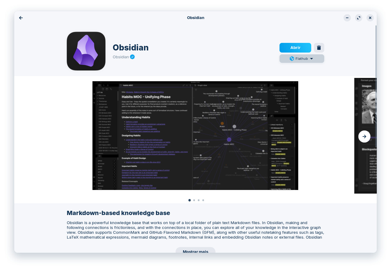

This is an example of a program showing the flatpak as the zorin recommendation.

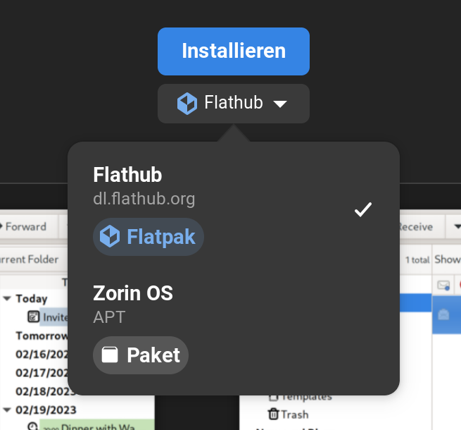

When You click on the ''Flathub'' and there is a Zorin APT Package available, You can click on this Entry and then that will be installed. Look at this:
Because of Your List: Yes, the Stuff where ''Zorin'' stands is the Theme Stuff. That is okay. You have Dependencies of the Flatpaks installed that have some Influence.
Because of Your Disk Analyzer Picture: You see first the Downloads Folder. There are alone almost 20GB. Maybe You could take a Look at this.
I would have deleted all flatpaks with these commands. Flatpaks a resource hungry and i would not even want to use them.
flatpak uninstall --unused
flatpak uninstall --all
The first command will remove all unused flatpak dependencies from your system. And the second command will remove all installed flatpak applications from your system.
After above commands you can check flatpak app list using below command.
flatpak list
