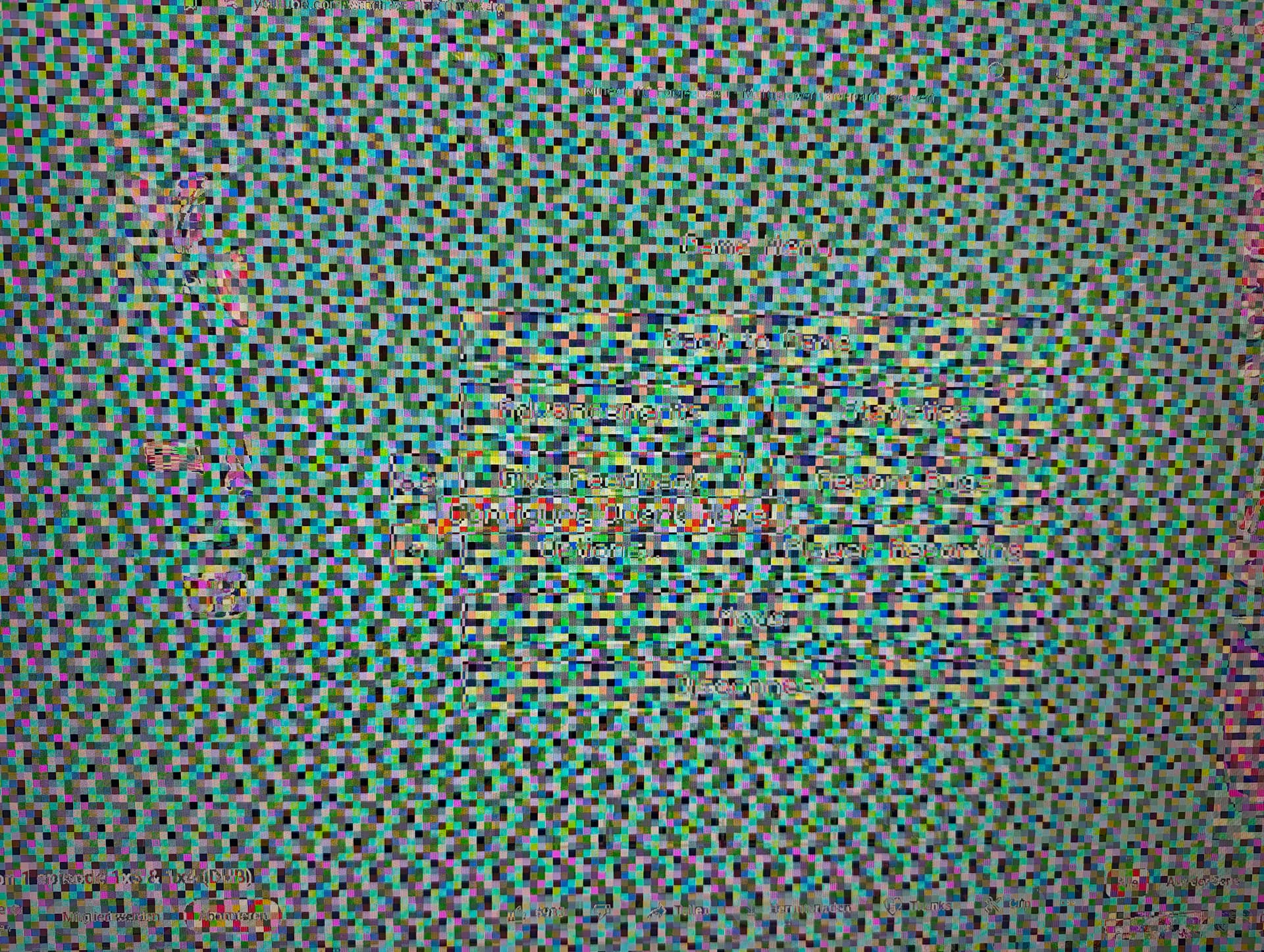

Oh and this is how minecraft looked when crashing and freezing my whole PC:
Aren't supposed to be cubes in that game? :thinking:

I first tried the normal driver coming with Zorin OS, and I tried using the AMD from their website. The one from Zorin os leads to the pixel mess, and the official AMD one leads into a crash of the game, but the PC stays functional. I am really thinking about a new graphics card. And I am still testing some stuff with Stable diffusion. Because of this, I am currently deciding, if I buy an nvidia or amd card XD.

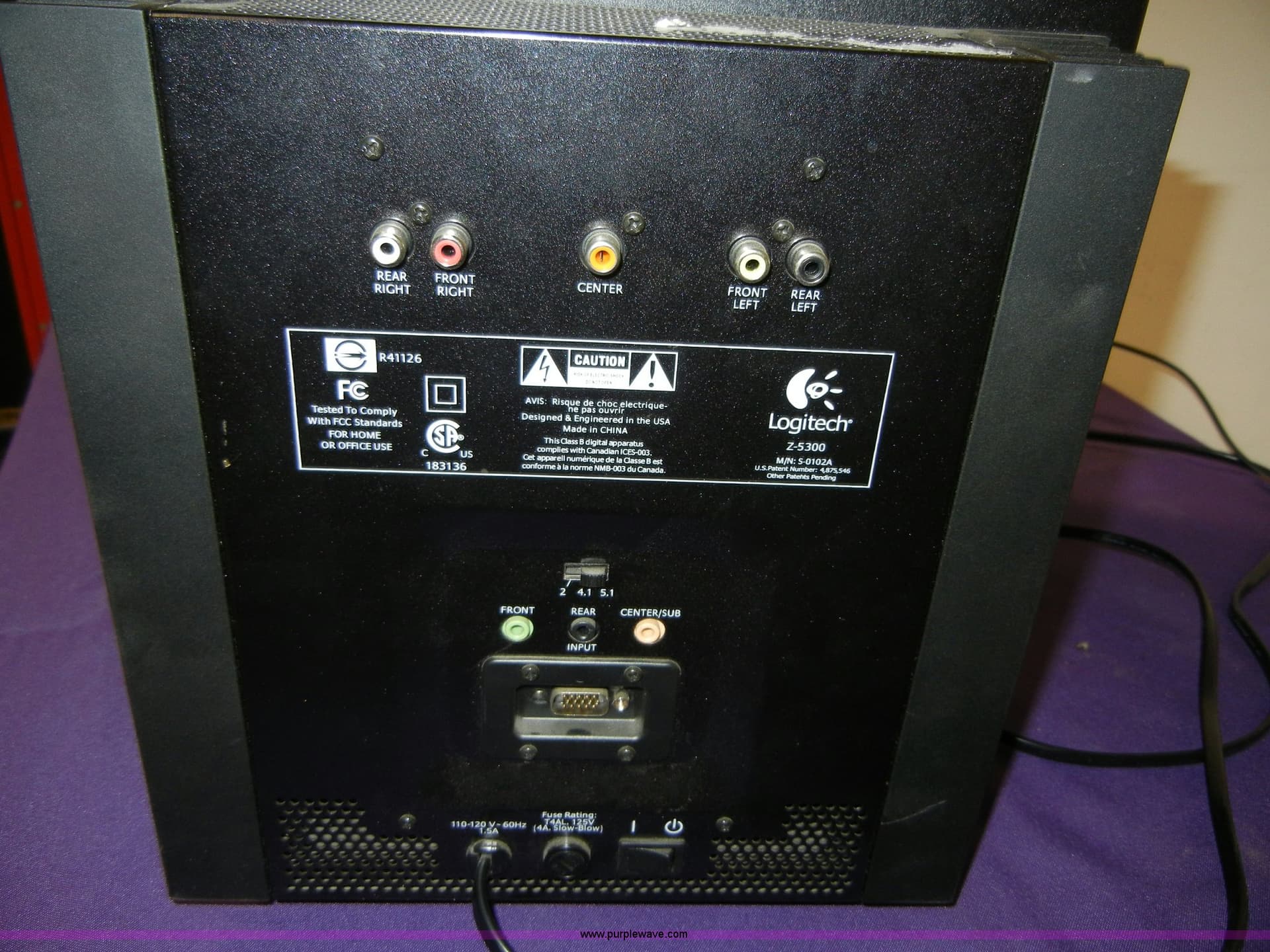

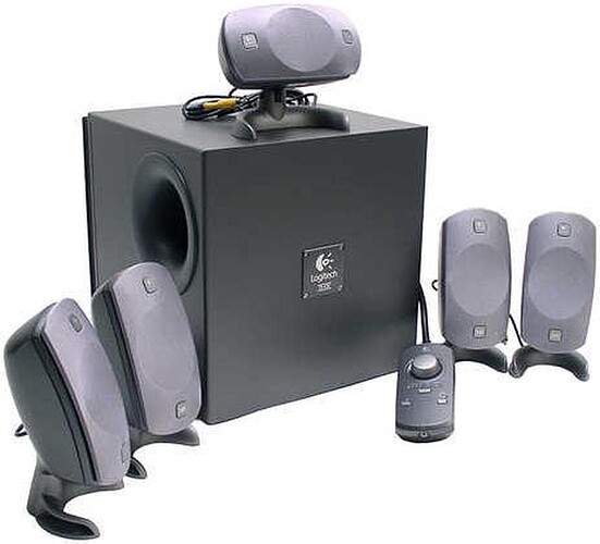

I also own a Logitech 5.1 surround sound speaker system. If I recall correctly, its a Z5300. Lets see how good my memory is, after having a stroke 3-months ago.
Oh look at that, my memory is better then the store I bought it from!
Here's the thing, back in the year 2003, I bought this baby from Best Buy. Those were the days, I was on a 20LB desktop then. I had a Logitech Sound Blaster 5.1 card, and the bits began to twits, and the code went out the ether.
So, I do know the battle you face, as those sound systems were designed to connect 5 connections via 3.5mm jacks. However, when I bought a new laptop computer, there went my 5.1, cause notebooks don't have 5 audio jacks.

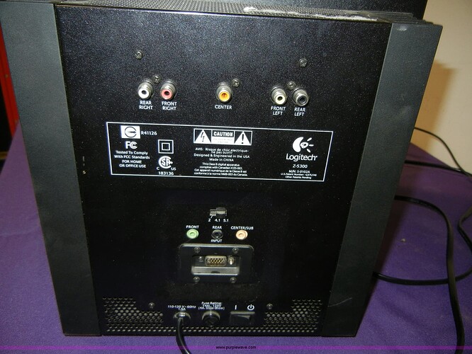

Here's what your likely dealing with...
Notice your input connections bellow. "Front" "Rear" "Center" All of which are 3.5mm jacks. The RCA's are only for the output speaker connections, and the VGA port, is for the wired remote control connection.

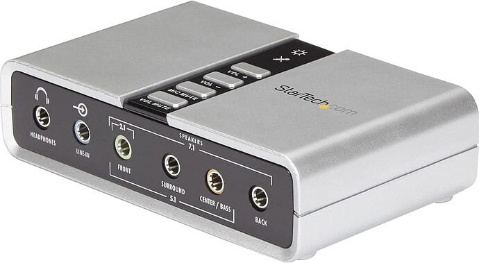

In your specific use case, I think whats best for you, is to use an external USB sound card, that has the available 3.5mm jacks on it. Have a look!
This ones from Star Tech, its capable of up to 7.1 surround sound. From your speaker system, connect the front cable to "Front" on this unit, rear to "Back" and Center cable to "Center/Base."
