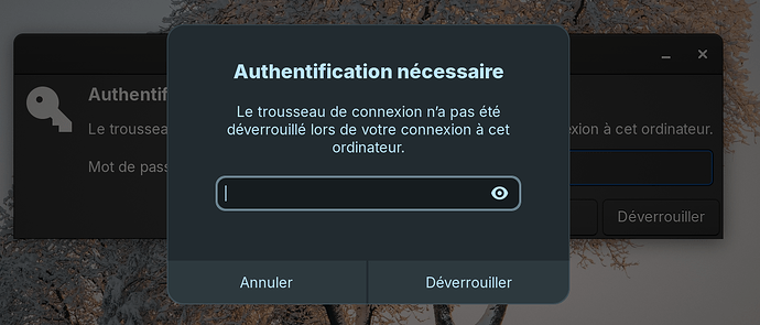

I second the issue. I have a Framework 13 and I freshly installed Zorin OS 18 Pro. I activated the fingerprint directly in settings => System => Users => Fingerprint login.
Since then, whenever I log in with the fingerprint, I got 2 Pop-Up that ask my password to unlock the keyring. It correspond to 2 different keyring:
Seahorse and gnome keyring.
If I log in with my password instead, both keyring are automatically unlocked. The behavior is only when I open the session with the fingerprint.
