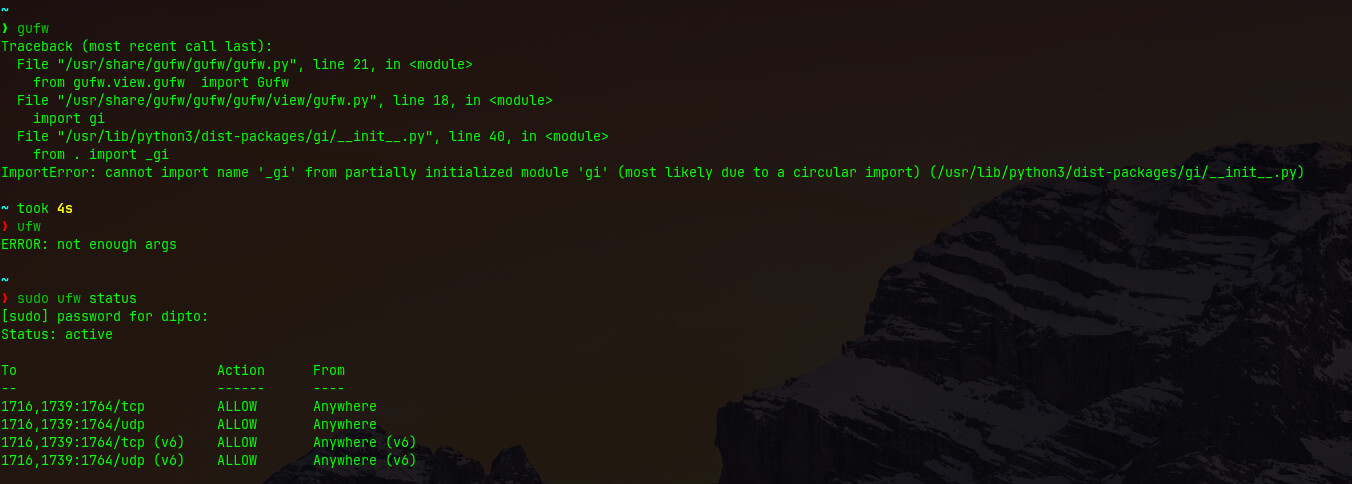

firewall gui is not working.
Note: I have also uninstall and then installed it. using this commands.
sudo apt remove --purge gufw ufw
sudo apt install -y gufw

No, not working.
Hmm ... I have found an askubuntu Article where is nearly the same Issue describted. Maybe this could help You. GUFW not launching
Thank you. but i will leave it as it is. I added the rules using terminal.

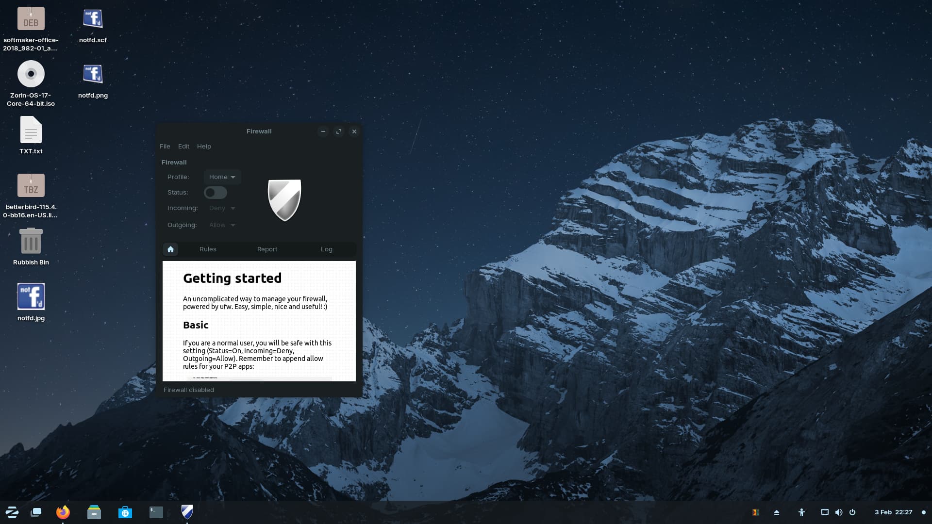

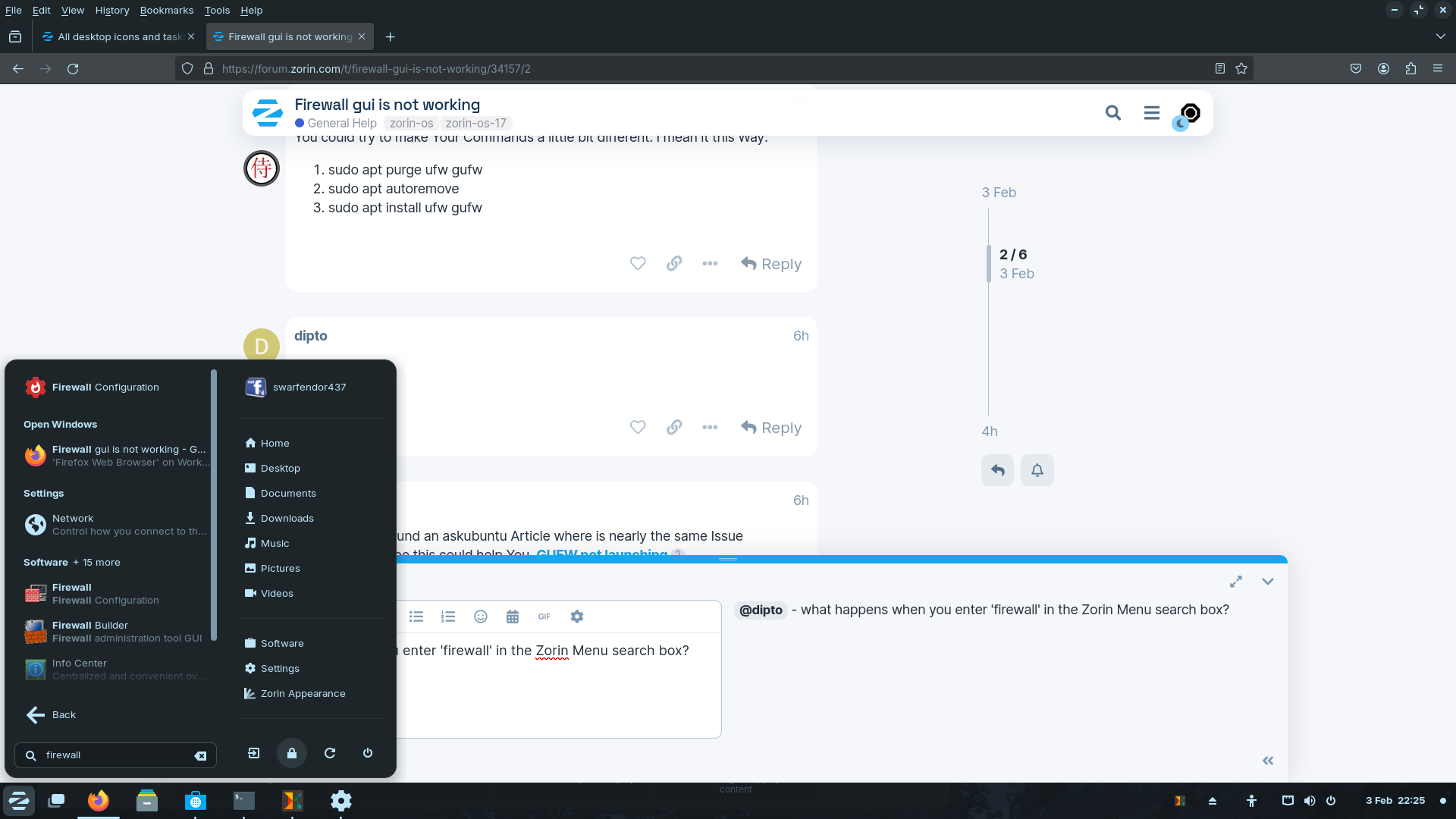

@dipto - what happens when you enter 'firewall' in the Zorin Menu search box?
If I select the first item:

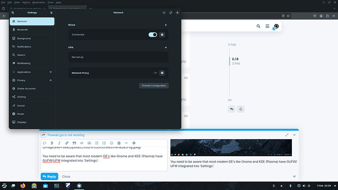

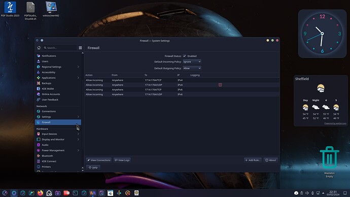

You need to be aware that most modern DE's like Gnome and KDE (Plasma) have GUFW/UFW integrated into 'Settings':
Zorin (Gnome) Network Settings:
KDE neonuser:
