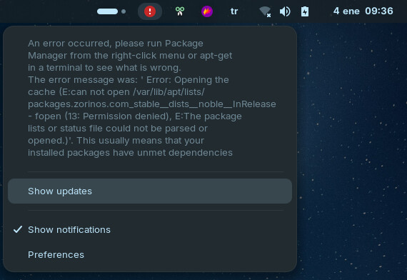

Fix "Error opening the cache, the Package list or status could not be parsed or opened."
Hello, I have this issue:
I know this would fix it:
But I got this error when I open my pc while there is no internet connection.
So I need a solution to not (try to) check the updates when there is no connection.
Thank you.

But this is the problem. When I open my pc I don't have internet. I have to open my mobile data and hotspot and update just to fix this. And next week the same case. (but for a different apt/lists list. There should be another solution.
For example today the error source is different:
