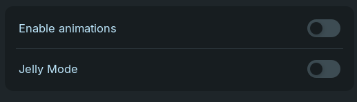

You should try it with turned off Windows Effects. Maybe these are the Problem.

What? Do you mean jelly mode?

Yes, and the other Stuff. I mean the appearing and disappearing Animations.
Like this?
I don't know how you set up the Animations above:
The Jelly Thing is one Thing. But You have these Effects when opening a Window (this Hexagon Thing) and when close a Window (this Breaking Effect). I don't know how You make that, Program, Gnome Extension or whatever. But turn it off and then try it.
I did, no change, but using kernel 6.8.0-51 instead of 52 fixes apps that use gnome theme something.
NOT RELATED TO DISABLING EFFECTS THO!
