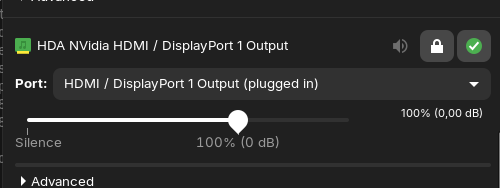

In pavucontrol is your audio output HDMI?

pavucontrol isn't recgnize in the terminal.
I upgrade to Nvidia DKMS 570 and still flickering the apps on full screen in the second monitor on xorg
Ah, you must install it then...
sudo apt install pavucontrol
Then launch from app menu or terminal
pavucontrol

As suggested, I installed pavucontrol . It shows I might be using DisplayPort1 (via NVIDIA HDMI) for audio output:
