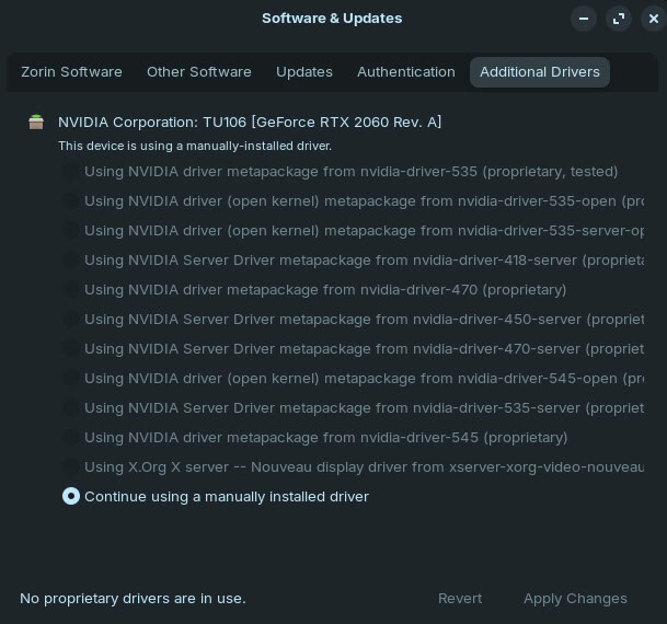

What for a Nvidia Driver do You have installed?
Screenshot says "No proprietary drivers are in use" so you are using Open Source driver not NVIDIA ?
Thank you for the Picture. There stand ''Continue using a manually installed driver''
Do You have manually installed an Nvidia Driver?
i don't know. when i installed ZorinOS i selected the option that was specifically for NVIDIA. perhaps i should install a "proprietary driver"?
all i did was install Zorin OS and select the option that was specifically for NVIDIA. i cant remember exactly what it said. how do i install the proper "proprietary" drivers?
i downloaded the .run file for my card from the nvidia webside and followed some online instructions to install the drivers but all i get is errors and fails. is there a drivers manager in zorin os that i can use?
