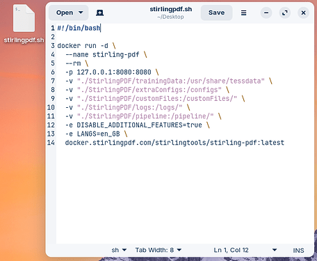

  4. Open a browser and up at the address back navigate to "localhost:8080" as per the screenshot below:
  5. Instead of repeating step 3 and run this every time through the terminal, you can place it inside a text file with an extra line at the top (#!/bin/bash) as shown here:

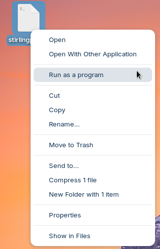

    Right-click the file → Properties → Permissions → Allow executing file as program.
  6. To run it, right-click on the file → Run as program:
    It won't seem to do anything, as this runs in the background. After a few seconds, in your browser, go to "localhost:8080" to access the interface.
