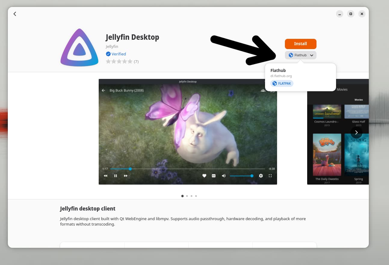

I opened the programs "store" and installed it from there so i guess it is flatpak then right? Thanks for your help in my Linux quest :slight_smile:
If possible try go to store and see if a .deb package is available.
If not, you need to install flatseal to setup Jellyfin to use GPU. Flatpaks and snap runs in sandbox.
