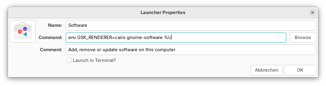

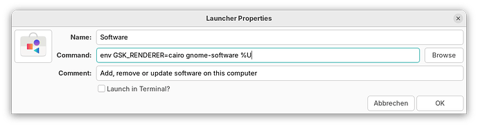

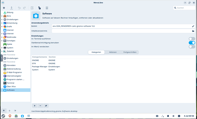

You can edit the .desktop file of gnome-software so that it always launches this way and you don´t need to use the terminal to launch it. If you also have problems with other gtk4 apps, you can also set an environment variable at ~/.profile with GSK_RENDERER=cairo globally for all gtk4 apps by adding the line export GSK_RENDERER=cairo at the end of that file.
To edit the desktop file right-click on the Zorin menu > edit menu
Go to system > software or software and change the command to
env GSK_RENDERER=cairo gnome-software %U
and then save it .
Here I found some informations about renderer:
Edit: I have posted a screenshot of the launcher properties in Zorin 18.1 core because I overlooked that you are on Lite, but the command is the same for the Lite version. Here you see how it looks in Zorin 18.1 Lite:
