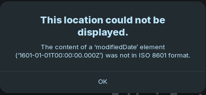

I synced my Google Drive account using the built-in Online Accounts app, but when I try to access the folder, I receive the error message below:
This location could not be displayed
The content of a 'modifiedDate' element ('1601-01-01T00:00:00.000Z') was not in ISO 8601 format.

I accessed my Google Drive using a web browser and ordered the files by Date modified, and I found the file with the year 1600. In my case, it isn't an important file, so I just deleted it, and everything is now working as expected.
I tried to apply the command you described, but it didn't work in my terminal. But your information about the modified date helped me to analyse in the web browser. Thank you.
