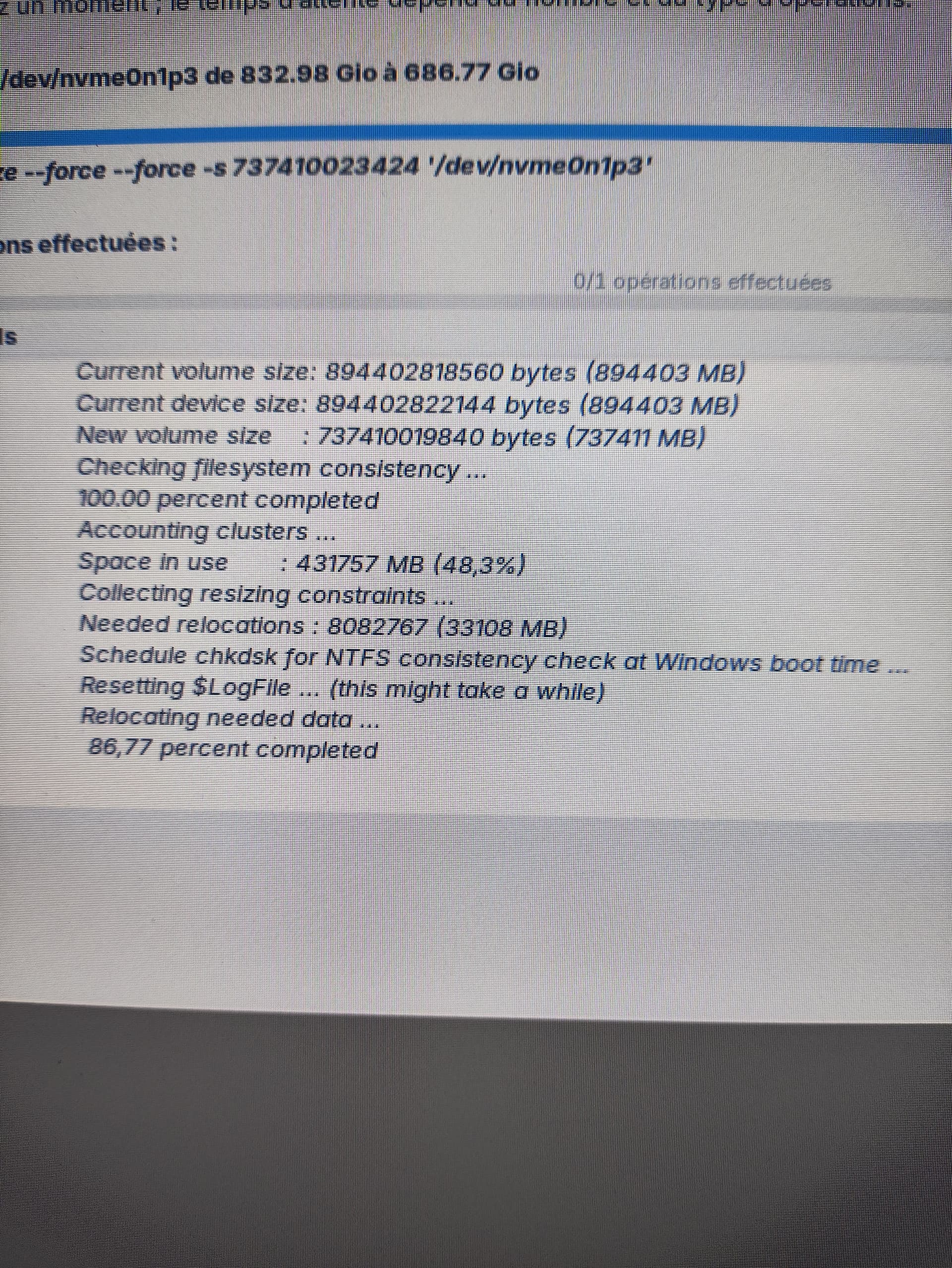

I have a dual-boot system and, in Zorin 18, I asked GParted to reduce the size of the Windows 11 partition, which is on the same SSD as Zorin. I think I must have done something wrong because now the PC are totaly freeze...

I launched gpaded from my Zorin session. Windows 11 hadn’t booted up yet, and fast boot is definitely disabled. Now it’s been stuck at 86.77% for 20 minutes and the PC is frozen, except for the mouse.

If Windows OS was fully shutdown - Fast Startup disabled... But if the NTFS was Heavily Fragmented - it may take a really long time to defrag and move a lot of files - so it may seem frozen. It might take a couple of hours.
The mouse cursor moves. That suggests that you are not locked up...
Running it From The Disk and not from LiveUSB is a risky move...
But it does not look yet like you are in the danger zone.
If a couple of hours pass with No Progress, then it may be the kernel stuck in an I/O loop and... the only way out would be a Force Shutdown followed by what I posted above about S.M.A.R.T. and using sudo ntfsfix...
Thanks, I’ll wait then. Even though it was almost over, it seems to me that very long time
