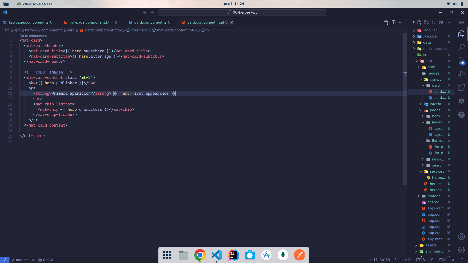

Hello everyone, I have an issue after tiling windows. The window on the right side of the screen keeps in transparency even after I restart the system. I don't know how to solve it
Your screenshot looks normal to me - perhaps I am missing something. Can you please highlight in the image what you are referring to?
I realized that in the screenshot is not visible, i will try to get it right
i was able to take a picture, is like the window that i tiled in the right stays even when it's closed
I can see why capturing a screenshot of this was difficult.

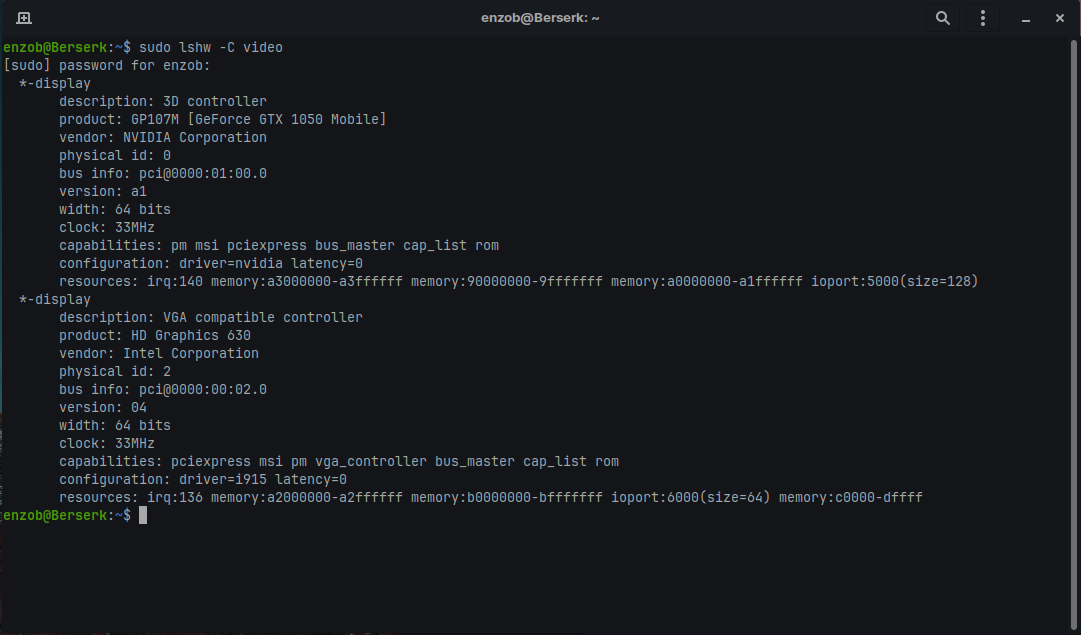

Can you please post the terminal output of
sudo lshw-C video
Your screenshot looks like Zorin OS Core, to me. Can you confirm that?
Thanks for the answer, yes, is 16.3 core, this is the output of the command

Are you using Nvidia on Performance only? Which Nvidia drivers? 470? 525?
Now that I have asked all that... I will narrow in further on my suspected culprit- The 630 coffee lake Intel drivers.
Which Kernels do you have currently installed? Have you booted up from any different kernel? And have you added any intel graphics boot parameters like i915.alpha_support=1?
