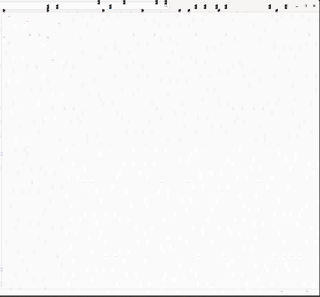

Hi everyone,
I’m experiencing a graphical issue on Zorin OS when the system goes into suspend due to inactivity (not when the monitor simply turns off).
To clarify the difference:
When the monitor turns off only, everything works normally when I wake it up.
When the entire system suspends automatically after inactivity, the problem appears after resuming.
After waking the computer from suspend, the screen shows noticeable graphical artifacts — like scattered black/gray blocks or “stains” across the display. In addition, small fonts look distorted or pixelated, as if the rendering is broken. The issue affects the whole desktop environment, not just a specific application.
The problem does not happen after a normal reboot. It only appears after the system resumes from suspend.
What I’ve observed:
Happens only after automatic suspend due to inactivity
Does not happen if only the screen turns off
Reboot fixes it temporarily
Small text looks especially bad
The artifacts are visible across the entire screen

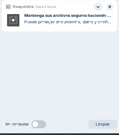

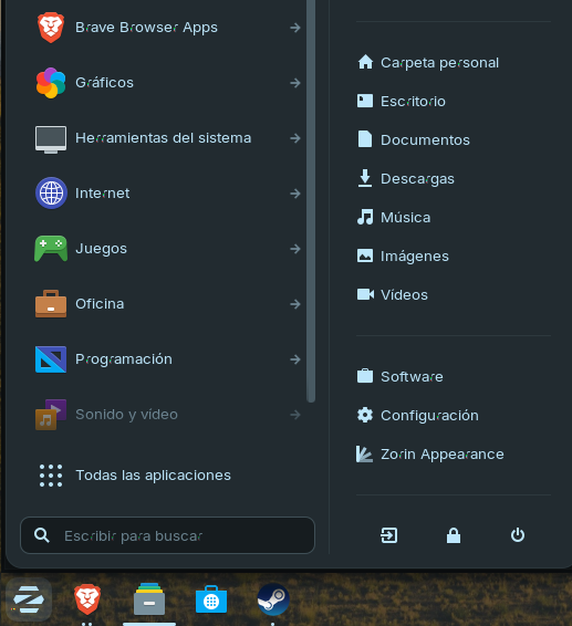

I switched to Wayland as suggested.
The situation has improved compared to X11 — I no longer get the large black/gray squares all over the screen after resume.

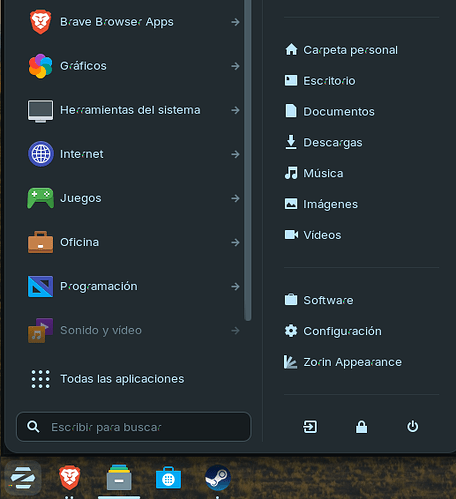

However, there are still graphical glitches present. As shown in the attached screenshot:
There are small visual artifacts near UI elements (for example near the “Z” icon in the taskbar).
Some fonts look slightly corrupted or improperly rendered.
The issue is subtle compared to before, but definitely still present after resuming from suspend.
So while Wayland reduces the severity of the problem, it does not completely fix it.

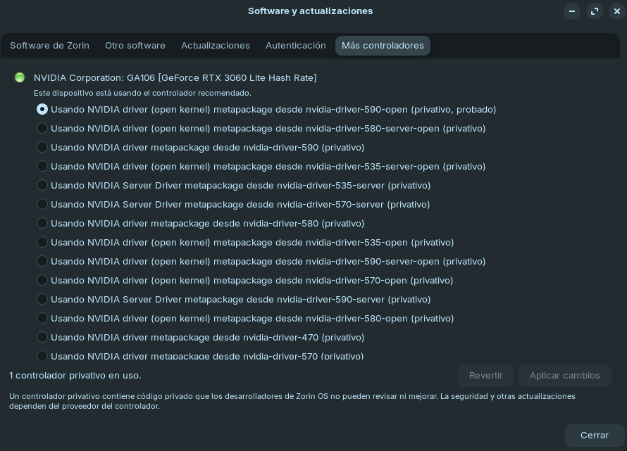

I am using the proprietary NVIDIA drivers selected through the “Software & Updates” application. Specifically, the one listed as: “NVIDIA driver (open kernel) metapackage from nvidia-driver-590-open (proprietary, tested).”
Could this be caused by the NVIDIA driver?
Good to see some improvement! There's two things I noticed, first is that in terms of the font, the 'r' alphabet has an issue being rendered, and for the Zorin icon issue, it's definitely an issue with the GPU (mostly the NVIDIA drivers).
I'd suggest you two steps that you can do one at a time, and you can report your experience here after the first step and then based on what has improved/not improved, I can suggest the second step or rather another solution altogether.
The first step for you is to switch to the older versions of the NVIDIA drivers (because it's always the graphics card causing the graphical issues). You can switch to the older ones and reboot after each version downgrade and test each version after suspend.

Maybe try the non-open Driver Version.

I then tried changing the NVIDIA driver. The latest one available was 590, but I installed 580 instead. I did not notice any difference, so I decided to try the open-source driver (the non-NVIDIA one). However, after doing that, automatic suspend due to inactivity stopped working, even though the option was enabled.
This morning, I switched back to the NVIDIA 590 driver (the one I originally had installed), and now everything works correctly. The system suspends automatically due to inactivity, and when I resume, the display looks normal with no graphical issues.

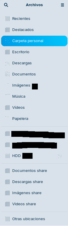

I tried the driver version 570 (the maximum available right now is 590) and it seemed like everything was working fine. The system has suspended 3 times today. The first 2 times there were no graphical issues.
The third time it also seemed like there were no graphical issues, until I opened the file explorer and in the left column I found the glitches.
Now I don’t know if this issue, which seems much less serious and doesn’t affect as much (for now), happens randomly or depends on the driver.

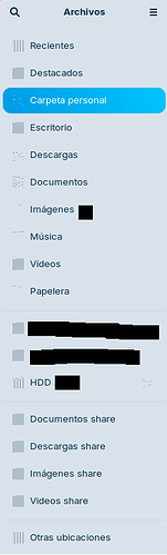

I was also able to check that the Files application (Nautilus) was open when the system suspended. After resuming, with the graphical glitch present, I closed that window and opened it again and it was fixed. But I imagine the normal behavior of the system should be to keep everything correct as it was when it suspended.
Great to see more improvements! I think this has something to do with some graphical rendering information corruption of the apps/UI elements that were stored on the GPU memory before the suspend session. In case these glitches are currently happening only to apps that weren't closed and not at all to the rest of the UI after suspend sessions, then I can suggest you two options:
  1. Remain with the Driver Version 570 (Open/Server, whichever you found success on), and make sure to either close all apps before suspending or after suspend, restart all apps (my suggestion) that were left open before the system entered the suspend session.
  2. Another solution I once saw while questioning this issue on Claude AI was to refresh the GPU state after the suspend session, which might be helpful. Here's the output+commands I've asked Claude Haiku 4.5 AI to generate:

Thanks, that could indeed be the reason, that it’s not restoring the state properly.
After writing my previous message I looked more closely, and it’s not just that some elements are not displayed correctly. The icons that appear normal are actually being replaced by others.
Since this is a minor issue and it can be fixed simply by closing the window and opening it again, I’ll keep using this driver. I also haven’t noticed any difference in games. I’ll continue testing to see if these are the only glitches and if the more serious issue from the beginning doesn’t return.
As for the script, as you mentioned it was generated by AI, and since this is my main system I’d rather not test it in case it breaks something. If this were a test machine or a secondary system I would probably try it.
