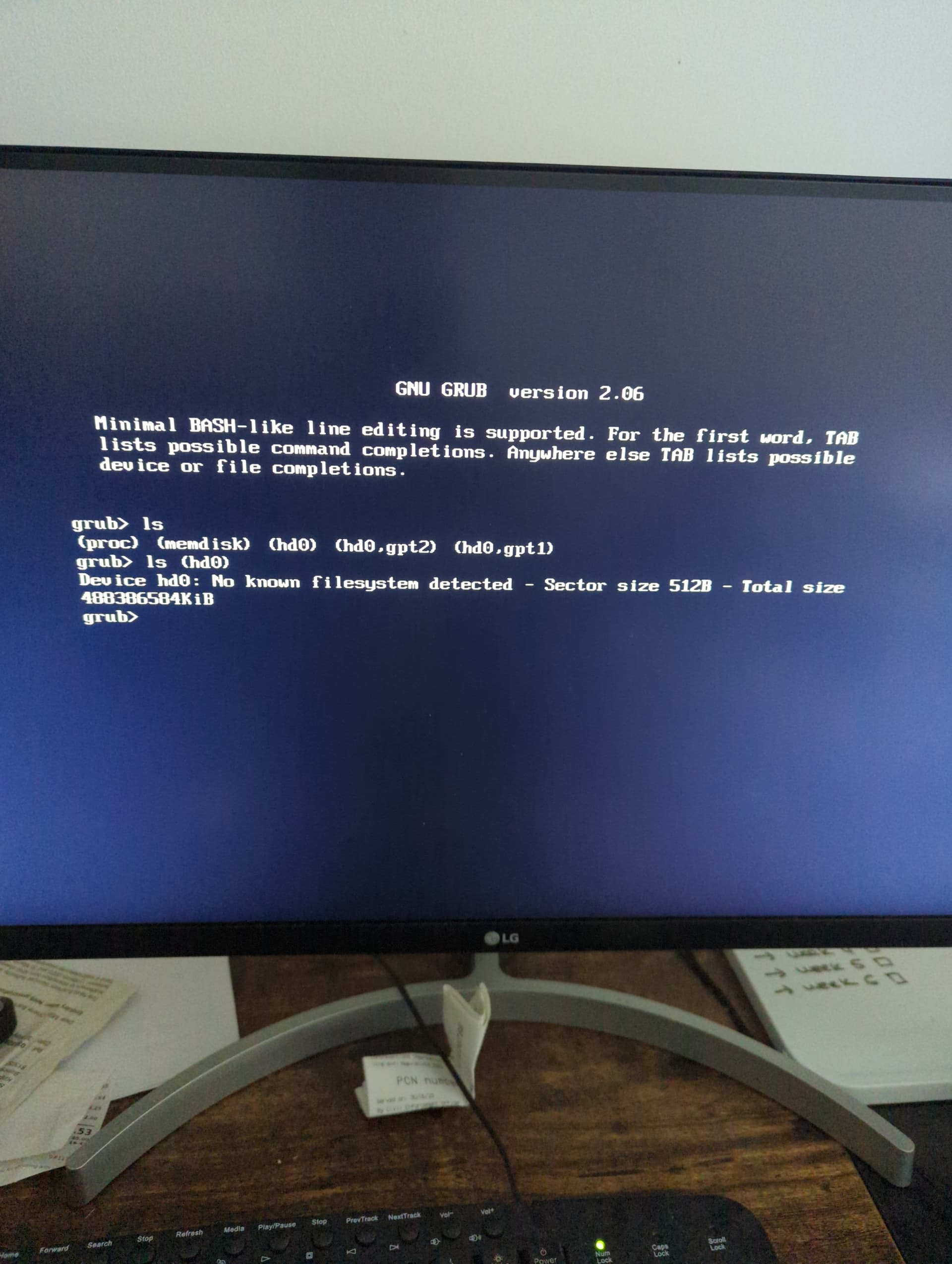

Hello there, I have encountered an issue with my main boot on Zorin OS. While attempting to install another copy on an SSD-USB drive, I accidentally messed up the main boot configuration. Now, when I boot up, I am greeted with the message 'GNU GRUB version 2.06.' I have already tried using 'boot repair' via a USB stick, but it resulted in an unusual error. I am seeking assistance in resolving this problem without losing any files on my main operating system. Any information or guidance would be greatly appreciated."
You may need to boot into a LiveUSB and run gparted. Reformat your EFI 512 partition.
Then, run Grub repair on it.
