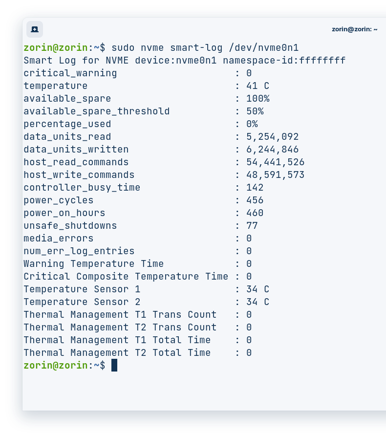

I was advised by Zorin support to boot from USB and test the disk but there's no problems there:
Any ideas how I could troubleshoot this?

You might try reinstalling GDM or using the nomodeset grub parameter.
It looks like the additional process of verifying the LUKS authentication is adding to your boot time in a way that times out the graphics drivers init prior to reaching the desktop.
