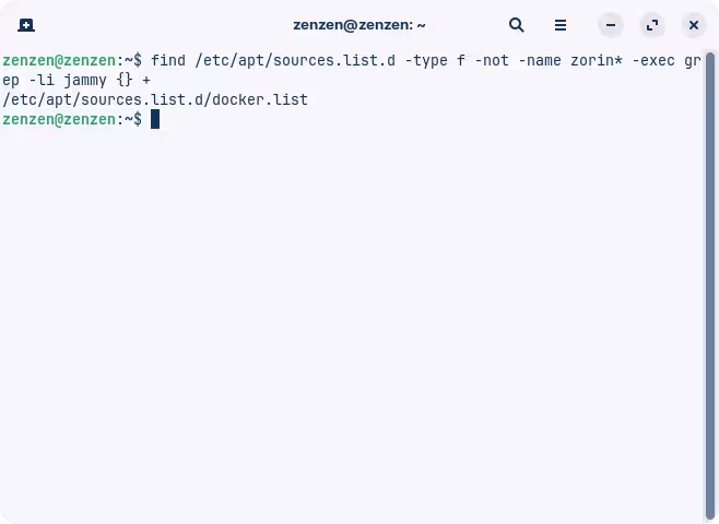

find /etc/apt/sources.list.d -type f -not -name zorin* -exec grep -li jammy {} +
If there's no output after running this command, you're all set. Otherwise, you'll have to remove or disable the repositories. In my case that would be the one from Docker:
We'll run another command to do just that. I prefer renaming the files in case something goes wrong later on. Once the upgrade is successful, these repositories will need to be replaced with their updated versions.
find /etc/apt/sources.list.d -type f -not -name "zorin*" -exec grep -li jammy {} + | sudo xargs -I "{}" mv {} {}.bak
This one is a little longer but all it does is finds the potentially problematic repository files, as before, and renames them by appending a ".bak" extension to them. This is safer than deleting or modifying any files, and the system will ignore these files entirely during the upgrade (it should, anyway).
Running the previous command shows that the Docker repository has been renamed successfully:
