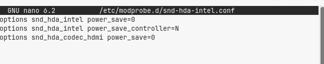

And you tried it with /etc/modprobe.d/snd-hda-intel.conf from the askubuntu Thread, too yes?

and my conf
