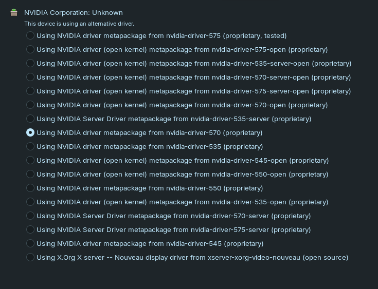

Did You take a Look in the ''Additional Drivers'' Tab in Software & Updates if there is a Driver offered?
