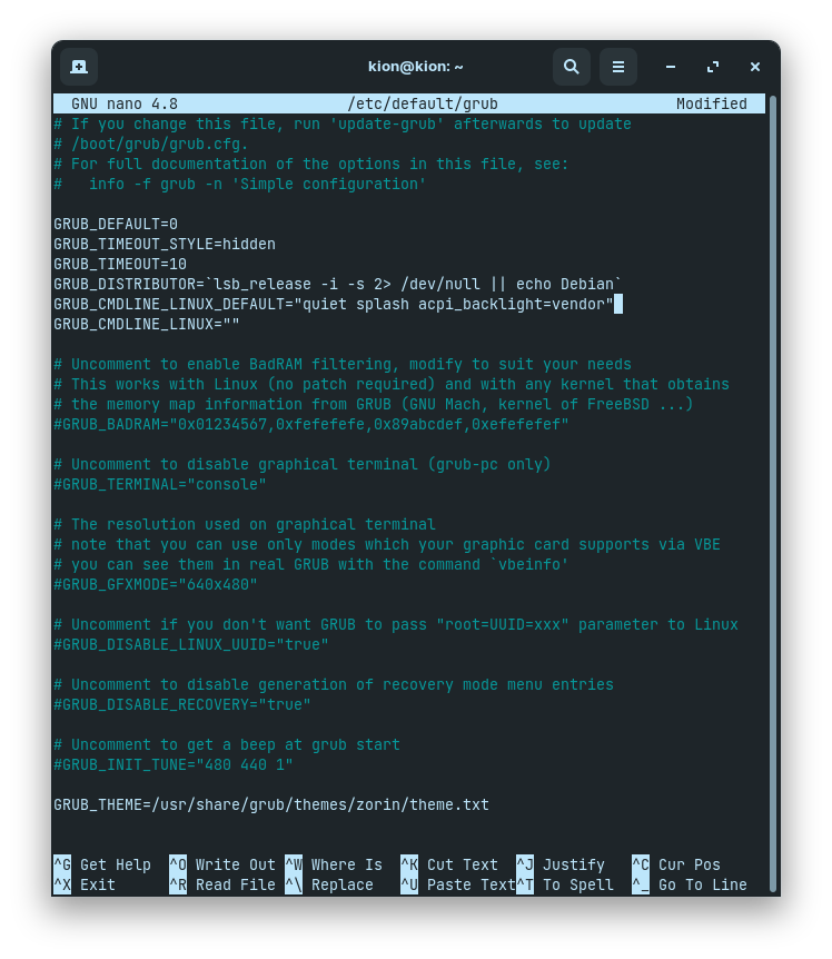

Look at this line:
GRUB_DISTRIBUTOR=`lsb_release -i -s 2> /dev/null || echo Debian`
In yours, in the screenshot, you have a (") that shouldn't be there...
GRUB_DISTRIBUTOR=`lsb_release -i -s 2> /dev/null || echo Debian`"
Please remove that (") symbol at the very end of the line so it is
and sudo update-grub and reboot and test...
Just noticed there is also a " after the =
Just wondering why there are so many mistakes in my file. I didn't do anything.
I removed the " but after update-grub I get the same answer.
I will restart now...
Neither of those should be there. It should look like:

But I did just spot More Quotes.

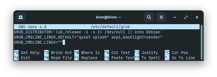

This line:
GRUB_CMDLINE_LINUX_DEFAULT="quiet splash" acpi_backlight=vendor"
It also has too many quote marks. It should be only beginning and end looking like this:
GRUB_CMDLINE_LINUX_DEFAULT="quiet splash acpi_backlight=vendor"
I assume that you did change these that I pointed out above?:
GRUB_DEFAULT=0
GRUB_TIMEOUT_STYLE=hidden
Sorry that I did not spot the additional quote mark earlier. I have no idea how your grub got riddled with so many of these...
Once you make the changes above...
sudo update-grub

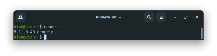

Your error message confuses me. What is going on with your kernel?!
Please post the output of uname -r before you reboot to test the above...
yeah, I did everything you said and now the additional stuff.
looks like this now

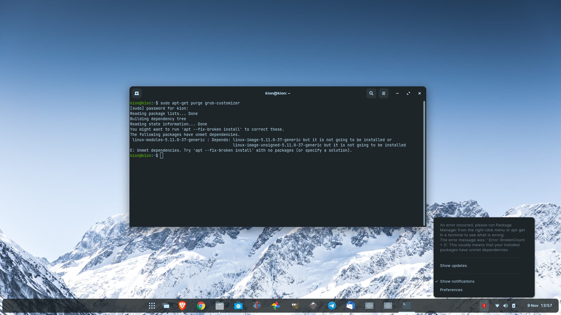

and whoowhooo something new as a result
and uname -r
Ok, run:
sudo apt --fix-broken install
sudo apt remove --purge grub-customizer
