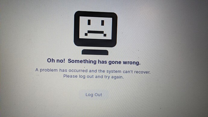

I dont understand what may have caused it. I tried apt --fix-broken but didnt work and i dont remember doing anything that could have caused it, once i rebooted and i got this. How can i troubleshoot it or see the error log? This only happens for my user

No i dont, i was just customizing my desktop and at somepoint i did a reboot and i got this. Maybe i accident mv something or rm something that may resulted this i dont remember

I was just configuring wine, i chaged the icon of settings app and some other with edit menu. This happened to me again this is the second time. In the last restart as i can recall it was fine
I also clearly remember that before this happened i had the icons in the home directory and this happened... How can i check for gnome errors?
Ok by running journalctl i got Failed to start application launched by gnome-session-binary
Defined by systemmd
A start job for unit UNIT has failed
Unrecoverable failture in required component org.gnome.Shell.desktop
I think this may happen because of amdgpu how do i troubleshoot
