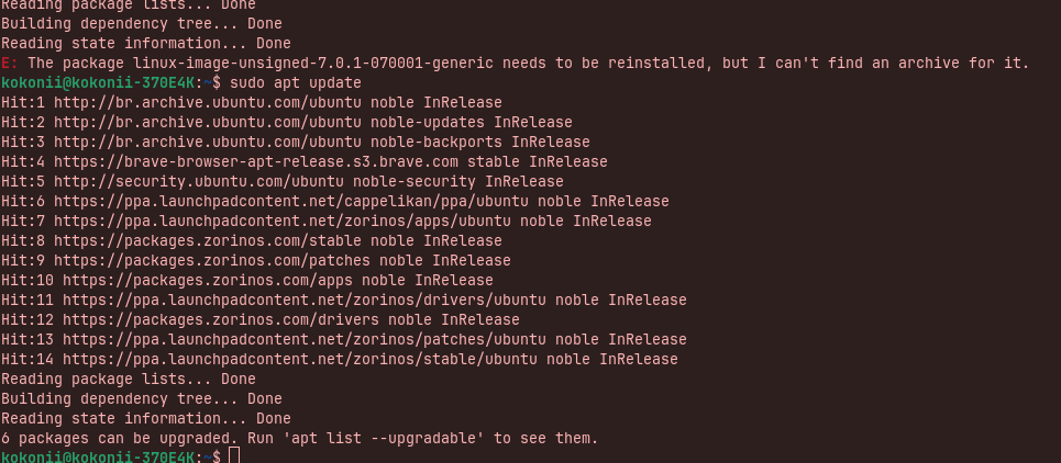

So, i'm a new user, with almost 0 experience in linux other than a few commands here and there. I was trying to download OpenTabletDriver for my drawing tablet, and this started appearing. I'm not sure why, but i've been all over the web looking for a way to fix it and i can't! :confounded_face:

What is shown in terminal when you enter
sudo apt update
It updates normally before this, but once i try to upgrade...

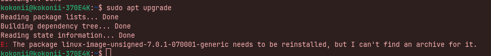

What is shown when you run
sudo apt upgrade
Here !!!
The package manager is defective at the moment and you can't install anything. Sorry, I don't know what to do now. Which kernel are you running?

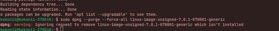

What is shown in terminal when you enter that command
sudo dpkg --purge --force-all linux-image-unsigned-7.0.1-070001-generic
You have added the Cappelikan PPA and tried to install the 7.0 Kernel which leads to this Error. Seems that something is broken and/or have unmet Dependencies and needs to be reinstalled. Do You need this Kernel?
