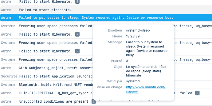

I am used to using the systemctl hibernate command to hibernate my Asus laptop. It has been working great, but for the past week, it wakes up immediately from sleep. There seems to be a busy resource that prevents it from going into hibernation, but I can't figure out what it is.

There it would be good to know what Process ... What stands in the Line under Your marked One? I mean, where stands ''Freezing user space ...''?
Freezing user space processes failed after 20.002 seconds (1 tasks refusing to freeze, wq_busy=0):
Here is a more detailed log:
Okay ... There stands ''start failed with result 'dependency' ... That sounds not very specific.
Then stands there ''Failed to put system to sleep. System resumed again: Device or ressource busy''
Maybe there is some Background Process that blocks the Hibernation.

I'd like to use the command "dmesg | grep xxxx" to identify the busy resource, but I don't know the process name.
