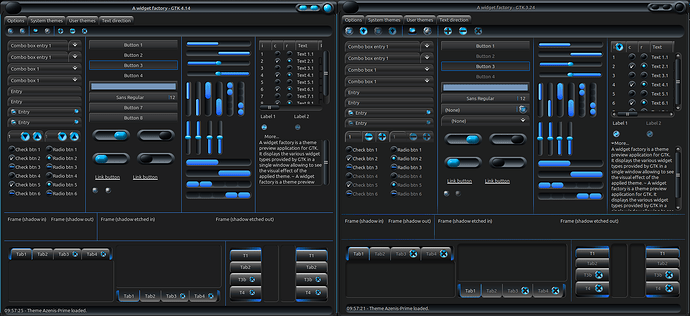

Then, it came down to my frustration over gtk2,3, and 4, all being used on the system, GTK4 simplifying and removing things... I need a new toolkit. One compatible with all three; but moves forward with one logical and versatile ToolKit.
Combining them into one was the logical course.
I've been calling it RTK for lack of anything better; fundamentally, it is GTK4, but with the best elements of GTK3 added back in (as well as fixing the LD_PRELOAD problem) and it does not rely on or call any LibAdwaita extensions; it is a unified modular toolkit, nothing more.
And so far, everything is working really well. Ignore the theme, it is being used to demonstrate ability, not looks.

I'm a fogey who prefers square corners, but otherwise, I actually like that quite a bit.
A simple script would square all the corners out, and about 7 minutes with Gimp in XFWM4 would get the titlebars.

Seriously though, the theme looked nice, and need not be ignored. :slight_smile:

What you are seeing above in the screenshot is Azenis-Prime, the latest incarnation that includes GTK4 and is my rebelliousness against Gnome, Flat, LibAdwaita... it is a statement.
And... I like it, too.
