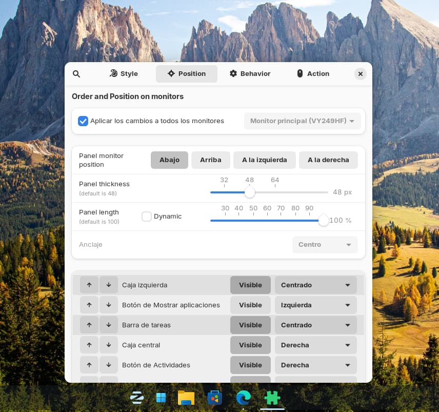

Im starting whit Linux and Zorin after a few post i learn a lot about how to custom mi desk and im making a scrip to reply all in others computers in my work, right now im stack whit this:
i want to change my configuration and make look like the image.
Can some one help me.

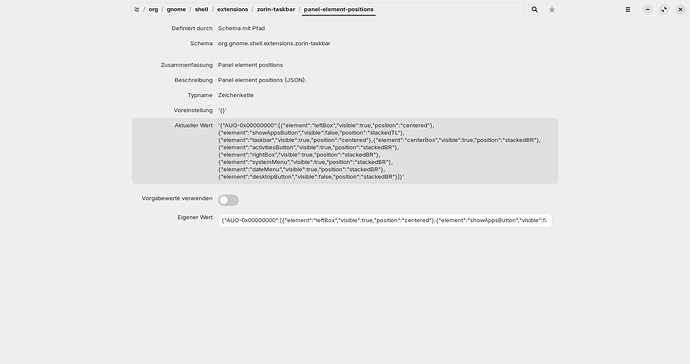

You can make all settings you like and then in dconf editor (you can install it with "sudo apt install dconf-editor") go to org.gnome.shell.extensions.zorin-taskbar and take a look there. On your screenshot were not all points shown for the panel position. I tried to make it as you but I'm not sure if it is right because it was in spain.
You can try then to set those positions with a terminal command on other computers
gsettings set org.gnome.shell.extensions.zorin-taskbar panel-element-positions '{"AUO-0x00000000":[{"element":"leftBox","visible":true,"position":"centered"},{"element":"showAppsButton","visible":false,"position":"stackedTL"},{"element":"taskbar","visible":true,"position":"centered"},{"element":"centerBox","visible":true,"position":"stackedBR"},{"element":"activitiesButton","visible":true,"position":"stackedBR"},{"element":"rightBox","visible":true,"position":"stackedBR"},{"element":"systemMenu","visible":true,"position":"stackedBR"},{"element":"dateMenu","visible":true,"position":"stackedBR"},{"element":"desktopButton","visible":false,"position":"stackedBR"}]}'
To read the current value for the panel position settings after you made the settings in a prototype you can also use the terminal instead of dconf editor and run
dconf read org/gnome/shell/extensions/zorin-taskbar/panel-element-positions

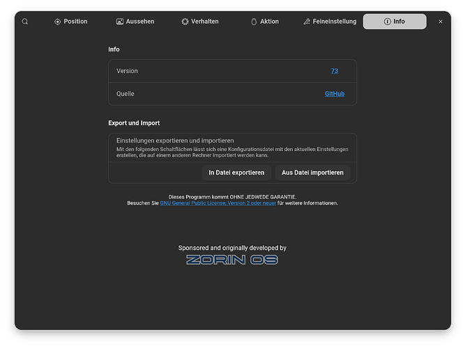

If You are open for an Alternative, you could use instead of the Zorin Taskbar the Gnome Extension Dash to Panel - GNOME Shell Extensions
There You have on the ''Info'' Tab Export and Import Options to export/import Settings:
So, You set up the Taskbar like You want and then export this. You take the File and import this on another System to get the same Setup.

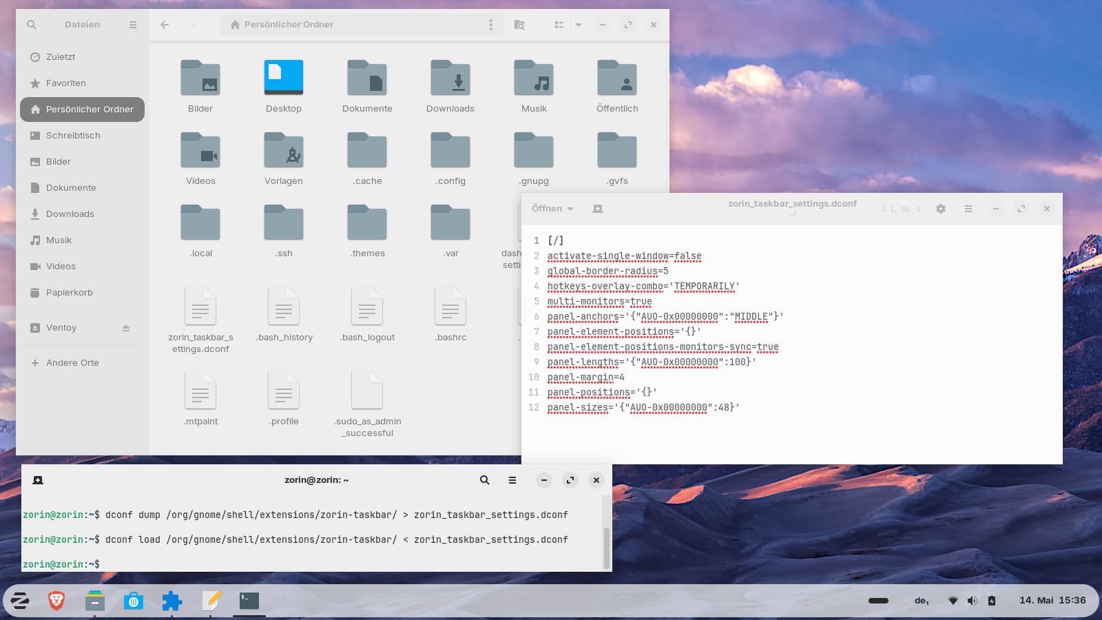

After a bit research I found a way to export the zorin taskbar settings and to import them. It worked well. I made some changes and exported the configuration with the command
dconf dump /org/gnome/shell/extensions/zorin-taskbar/ > zorin_taskbar_settings.dconf
(you can name the .dconf file as you like)
and then I changed the taskbar to normal. Now I imported my previous configuration with the command
dconf load /org/gnome/shell/extensions/zorin-taskbar/ < zorin_taskbar_settings.dconf
and the taskbar changed its look at once.
The file zorin_taskbar_settings.dconf which was created was saved in ~.
I think it should be possible to put that file to another computer and then run the dconf load command. I tested it with a new user account and copied the file from my zorin user home directory in the new users home directory, and it worked.

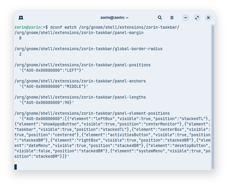

Today I found a faster solution to find out the terminal command for a setting in the taskbar so that you don´t need to search for the line in dconf editor. You can open a terminal and enter
dconf watch /org/gnome/shell/extensions/zorin-taskbar/
and keep the terminal opened while you make the settings in the GUI of the taskbar settings.
Then you see in terminal what is set.
You can then transfer the terminal output into a command by adding gsettings set at the beginning and replacing the path.
E.g.
To change panel margin
gsettings set org.gnome.shell.extensions.zorin-taskbar panel-margin 8
