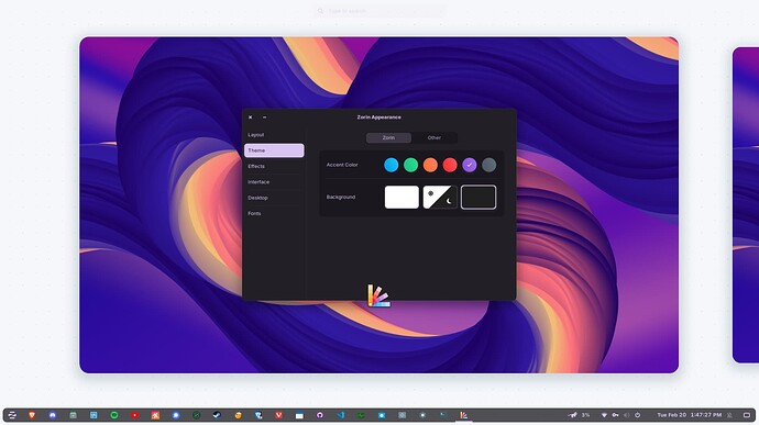

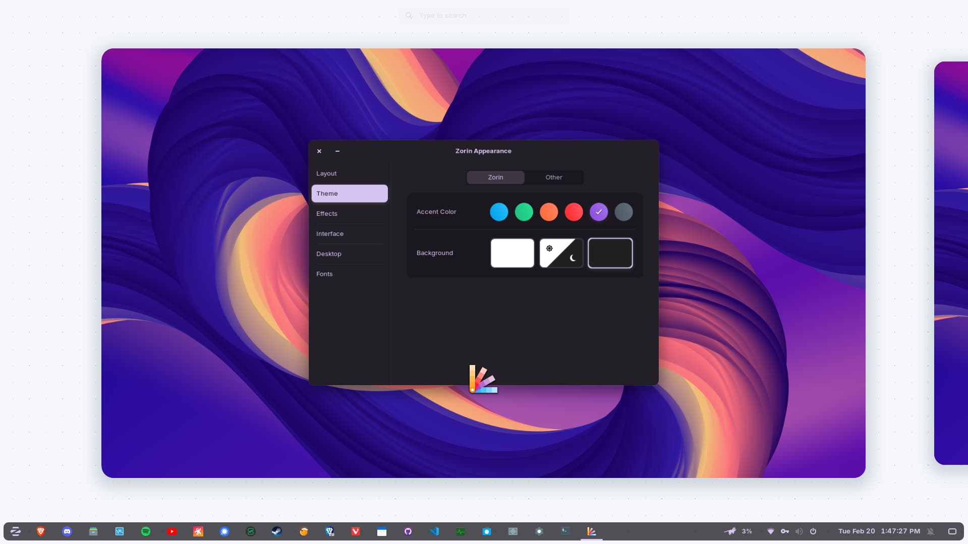

How can I fix the overview background not updating accordingly with my theme?
Upgrading my desktop, to ZorinOS17, and that happened.
Also not sure if it is related, but some apps still use the old theme

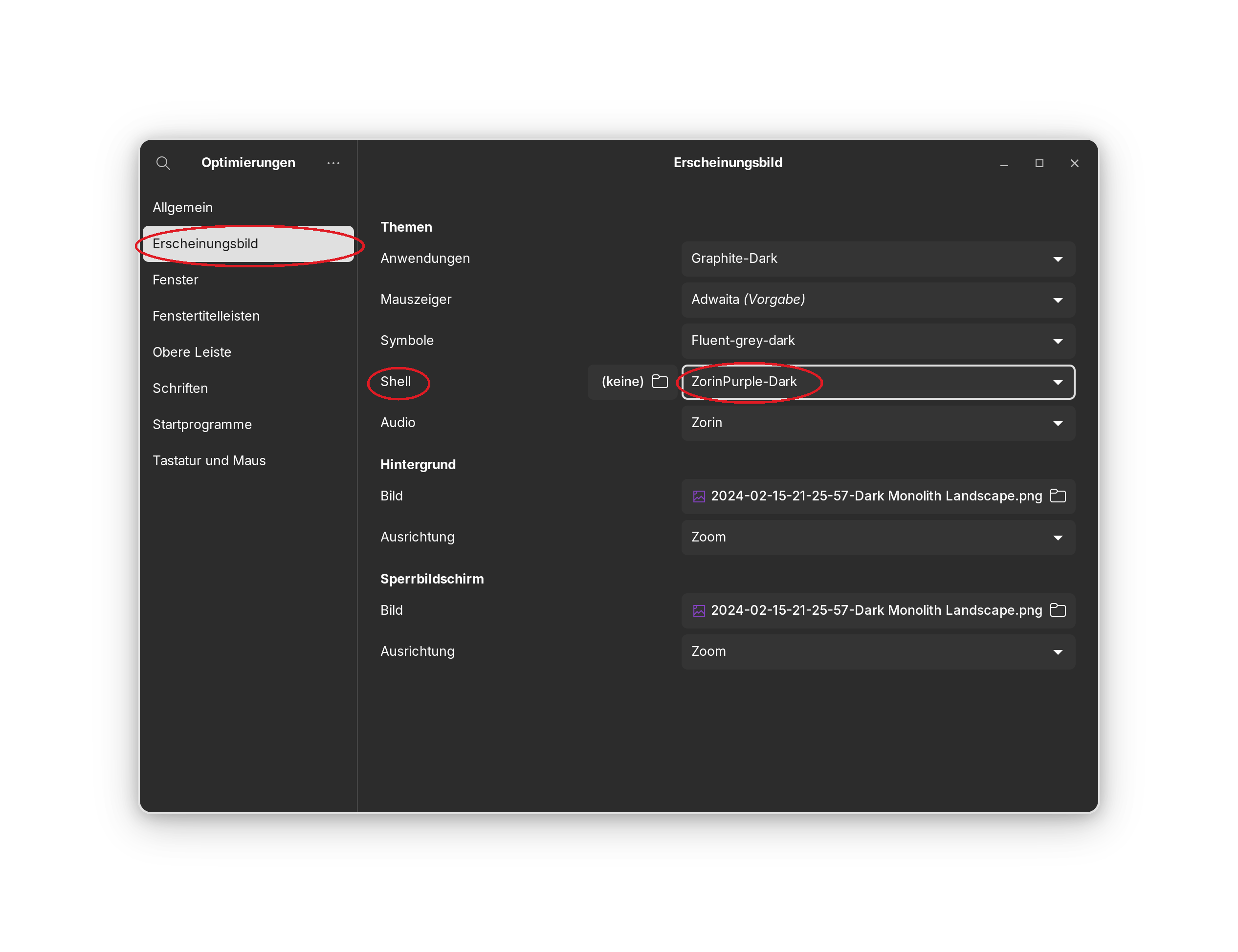

When You installed it open it and go to the second Menu Entry. There You have the optical Settings. There You should go to ''Shell'' and choose there ''ZorinPurple-Dark'' and then the Background should changed. Here a Screenshot:

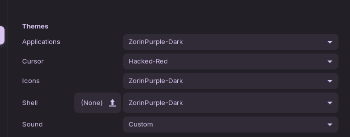

i manually changed it to something else then changed it back and I still have the same issue
3
Also I noticed like the quick settings too only recognize the default blue light theme
So, You have still the white Background even with ZorinPurple-Dark? And the blue Accents? You could try a Reboot of Your PC. Maybe then the Changes will work.
