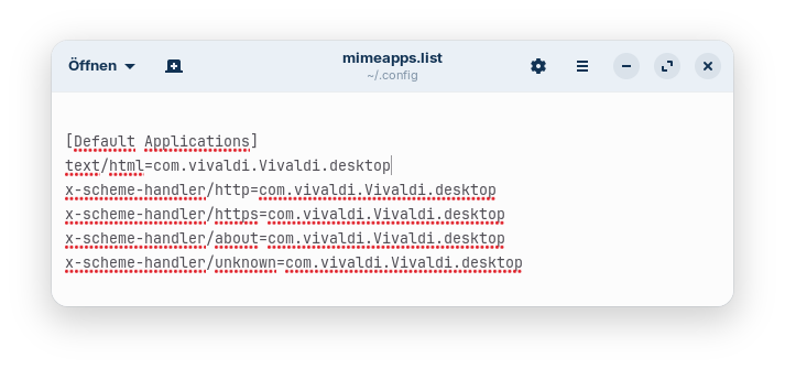

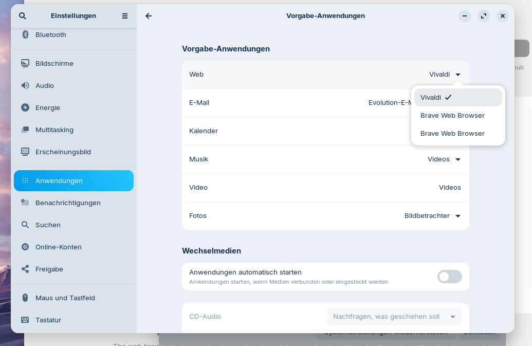

This command has worked for me to set Vivaldi as default browser:
xdg-settings set default-web-browser com.vivaldi.Vivaldi.desktop
I'm not sure if it is the best solution, but now Vivaldi is shown in the applications list:
